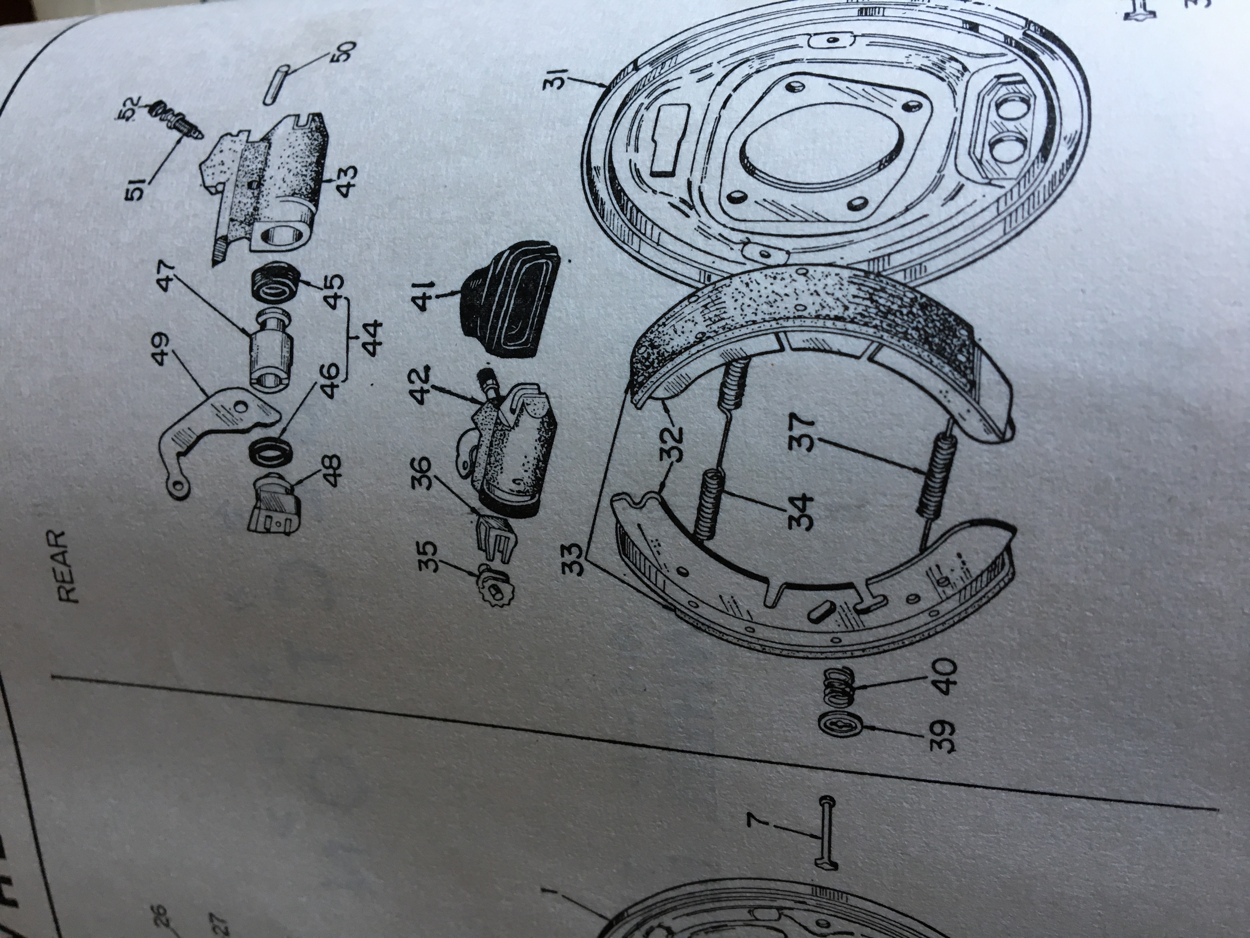

But another problem has came up - can anybody tell me a spare part serial number or code for the brake cylinder (inside the drum) gasket. It is impossible to search it by measure. I'm sure the same gasket can be found on other cars also, but the problem is finding it. If anyone has a part number, it would help finding it.

How are the bits you seek going ? This is the brake diagram. Do you mean the the wheel cylinder as in 17 on front and 42 on the back. Let me know I will douce the part number for you

Here's the rear

What I need is detail number 20 on the front brake diagram.
I believe it can be found on other cars, but it is impossibe to find it from spare parts database by measures. Some serial number or part code would be really helpful.
Tomorrow I'll go check in a hydraulics shop, they thought that finding it by size would be possible.

It's a gasket between the cylinder and piston.

Hi here's another photo it's a piston cup.

I am not sure about the term, but my problem is a leak from that "cup". Need to replace it, but of course it's not possible to brake repair kit for Bellett, so I need to find a replacement.
Let's see what the hydraulics guys say.
