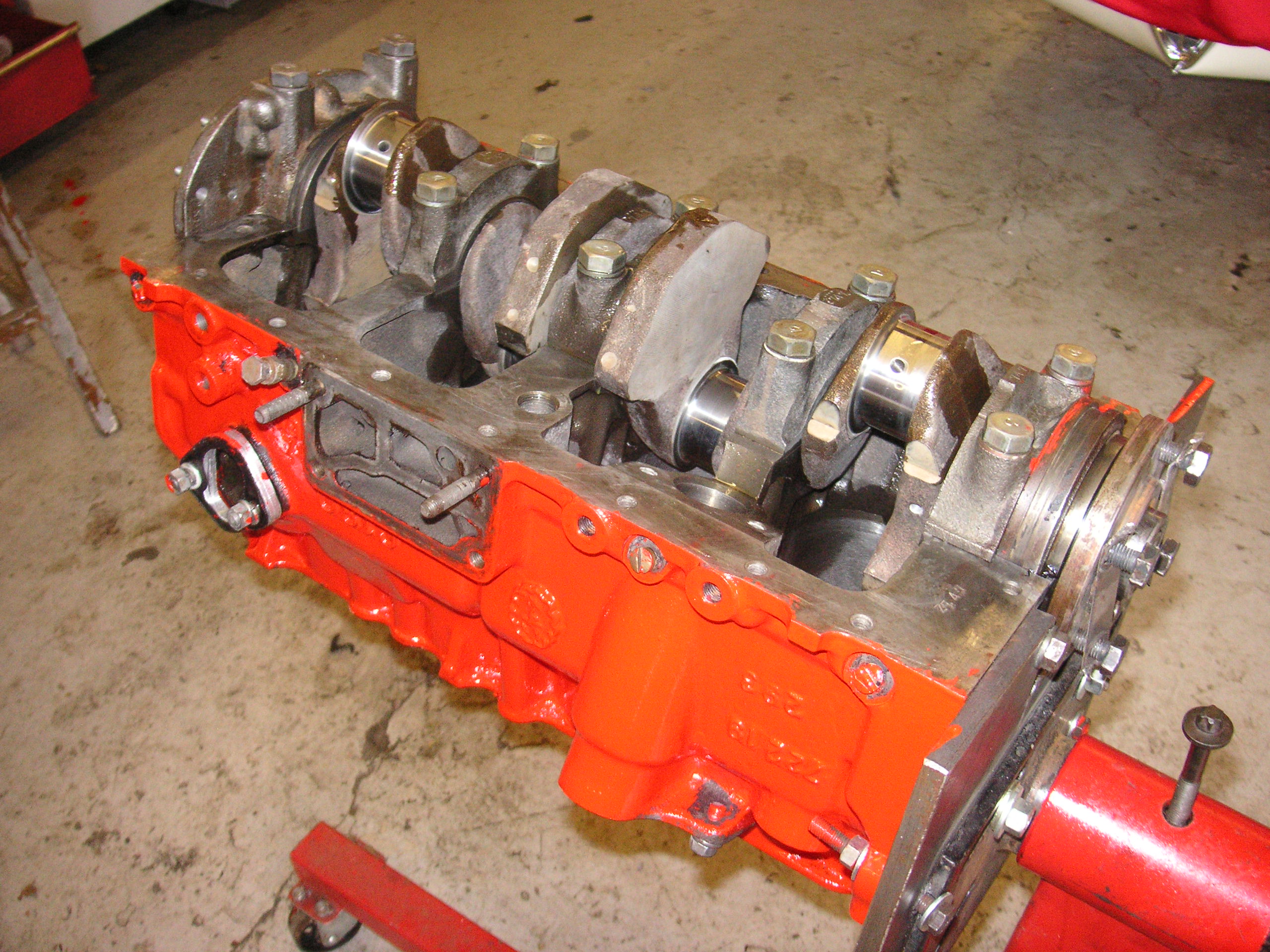

OK Rolie fans...the block is back, the crank, flywheel and clutch are balanced.
And we've splashed Sticky's favourite 'go faster' super quick paint all over the place.
My 'aero' spec rods don't match the gudgeon pins, so there's a little extra work to be done there, but otherwise we're on schedule...........good grief, did I really just say that?!

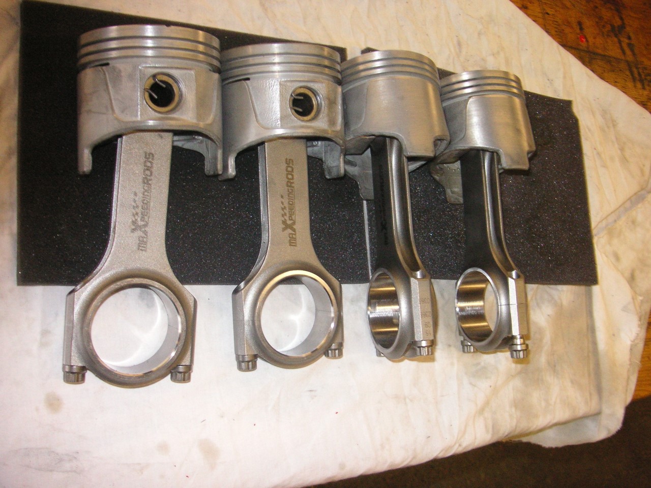

Damn right Sticky, although if you think the paint looks quick....check out these rods.
They've even got "maXpeeding" embossed on them!

Those beauties look as though they would empty your wallet at least 2 seconds a lap quicker :P
There are only termites that have starved to death in my wallet :roll: :lol:
Hope they are 'fast' as they sure look expensive ..........
Tue Oct 10, 2017 7:52 am
One of my 'mates' at the pub remarked...."the only thing that'll match the hole in your wallet will be the hole in the side of your block after the first test"
