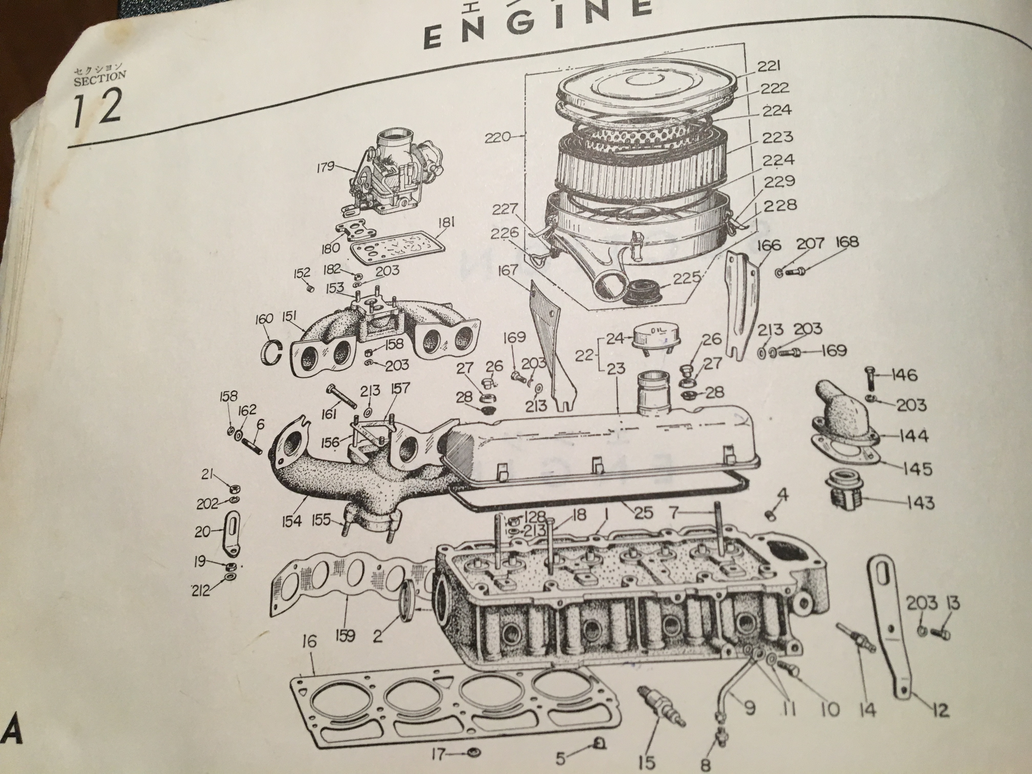

Finally got oil filter changed, and tried running the engine again... Valves seem to tick quite loud. Is it normal for that engine or should I adjust them? I don't have a spare valve cover gasket, so it's quite a risk to dismount the cover.
Any suggestions what to do and what not to do while adjusting the valves?
What does this lever under the air filter box do?

The lever under the air filter box simply unscrews anti clockwise to remove the air filter box from the top of the carburetor. There should also be 2 supports bolted with 2 bolts each support that will need undoing either at the filter box or where the struts bolt to the engine where there is 1 bolt each strut.
Thu Dec 14, 2017 1:34 am
Looks like this number 226 is the arm that releases the grip on the carny throat Cheers davo

Interesting is, that when I tried to start the engine yesterday, It didn't start. But when I loosened that lever, It started instantly. At the same time, the airbox cover was off. I suppose it was just a coincidence then.

You should have a earth cable from the negative terminal on the battery to item 169 in the engine picture. I cannot see it in your pic of the lever under the carburetor. If it is there tighten it up. Could be the reason why it would not start and you played with the lever and it started.
You can make a tappet cover gasket from sheet gasket material. Trace around the outside of the cover with a marking pencil. Measure the width of the old gasket and mark that width on the inside of the traced mark. Cut the inner mark first then the outer. If you cannot get the correct thickness for the gasket. Make 2 and glue them together. Or. Glue the sheets together and then trace and cut. Depends on how confident you are in making the gasket. You also may have a problem in getting a sheet material long enough. Go diagonally across the sheet.

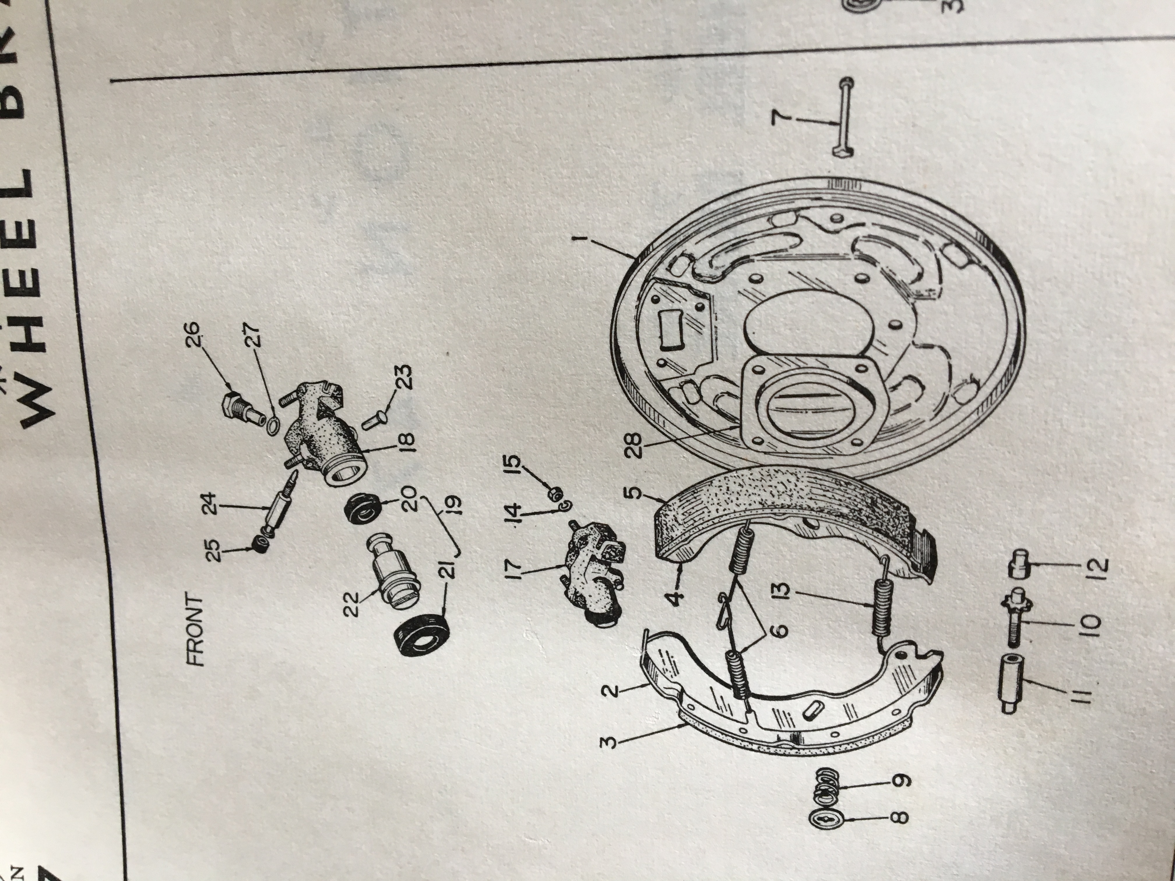

Today wasn't as shiny as I hoped it would be.
Tried to get the brakes, but there were many surprises.
Rear right brake cylinder had been made blind by someone. I suppose it had been leaking and instead of repairing (no surprise, because Bellett parts are not available in Estonia) it had been made blind.
I removed the blind from cylinder, tried, it seemed to work, but then the brake pipe broke when getting it back on.
As my brake pipe repair tool for 3/16'' pipe was also broken, I couldn't do anything about it today.
The cylinder itself was quite rusty inside. I suppose I would need a repair kit, but how to get the piston out?
I think I'll try to see if the cylinder works as it is, if it doesn't, I'll try to get a whole cylinder from Finland. Or is the rear cylinder with same diameter as the front? I have one spare front repair kit...

The brakes
Thu Dec 14, 2017 9:34 pm
Rear

Yes, thanks, I already had that chart. At first, I thought the rear brake piston wouldn't come out at all, but on the chart I saw that it should. I thing air compressor should help to get it out.
Main question is, would the front rubber ring (how is it called?) fit on the rear piston? Are the diameters same?
I guess I'll see on sunday if it works or not.
