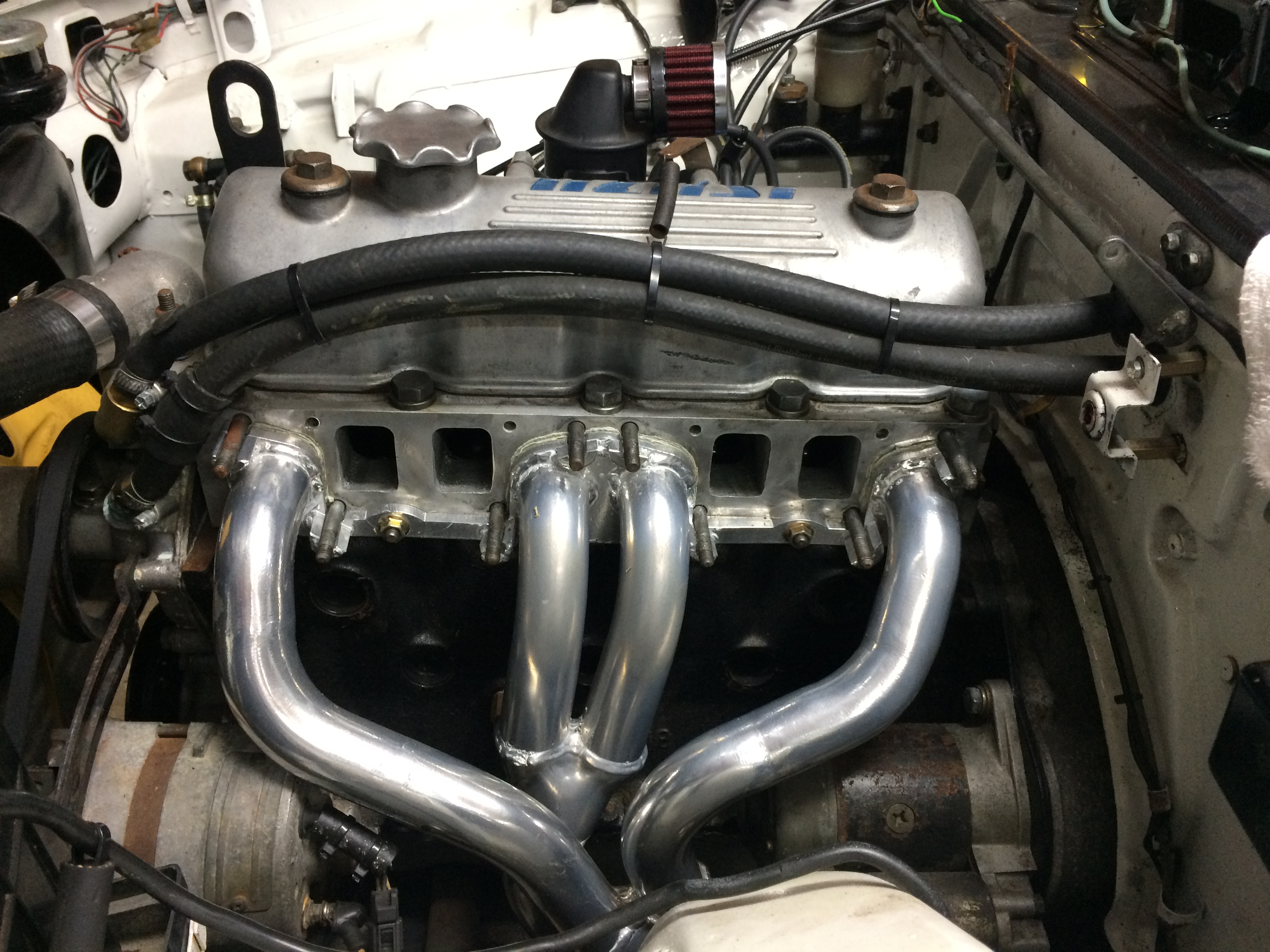

Hi from Tasmania
Well we are the coldest state here in Tassie though nothing like you so I run a constant flow through my heater
As you can see in the photo with carbies removed
Top hose return to thermostat housing on head
Low hose feed to heater from water pump
Traditional there is a manual turn brass valve at the head
Some remove and retro-fit an inline valve either manual or cable operated
Regarding levers I just move till I get what's needed where needed
Cheer
