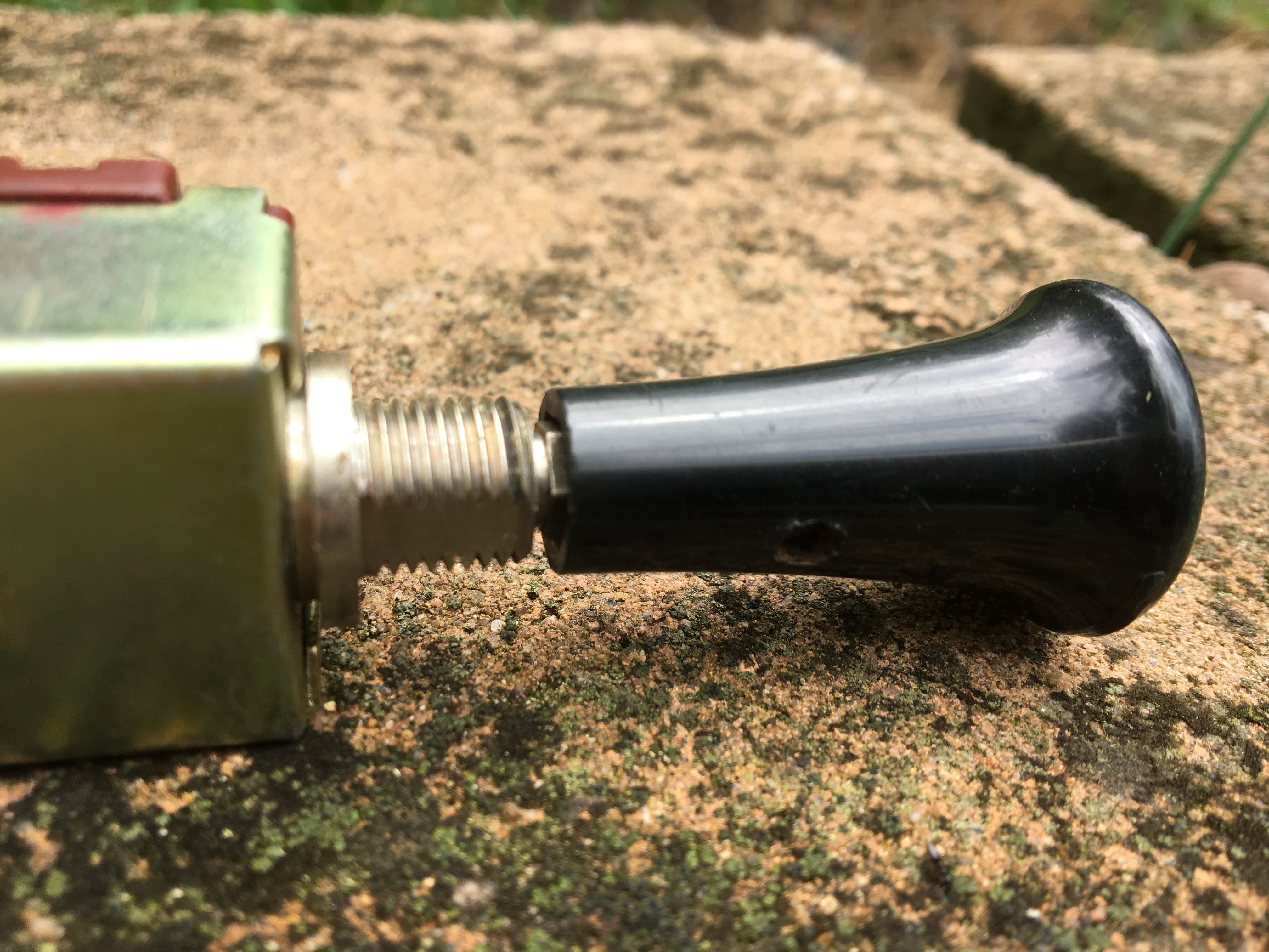

Every time I visit the garage, I seem to find another problem or some. Today I discovered, that one connector on the light switch is broken. That caused the heating.
How to remove the light switch plastic knob? There seems to be some kind of a brad in the knob, but I couldn't figure out, how to remove it.

Not very helpful... Any hint how to get the brad out?

push the little button on the side under the front of the switch I will take a photo tomorrow for you all is good ..cheers dave

Hi Bellett EST
On the bottom of the switch knob there is a small pin that holds it on. Just press a fine tool ( screwdriver or drift etc ) into the hole and gently pull the switch knob out. Unscrew the chrome ring and the switch will pull through the dashboard toward the front.
Hope this is a little more helpful.
Regards
Warren

The push in clip is the same on the wiper switch. A nail or sharp object. Pushed in and wiggleda bit then as abivescew it out cheersdave

as warren said push into that hole and pull off the plastic piece with L see how you go on it
