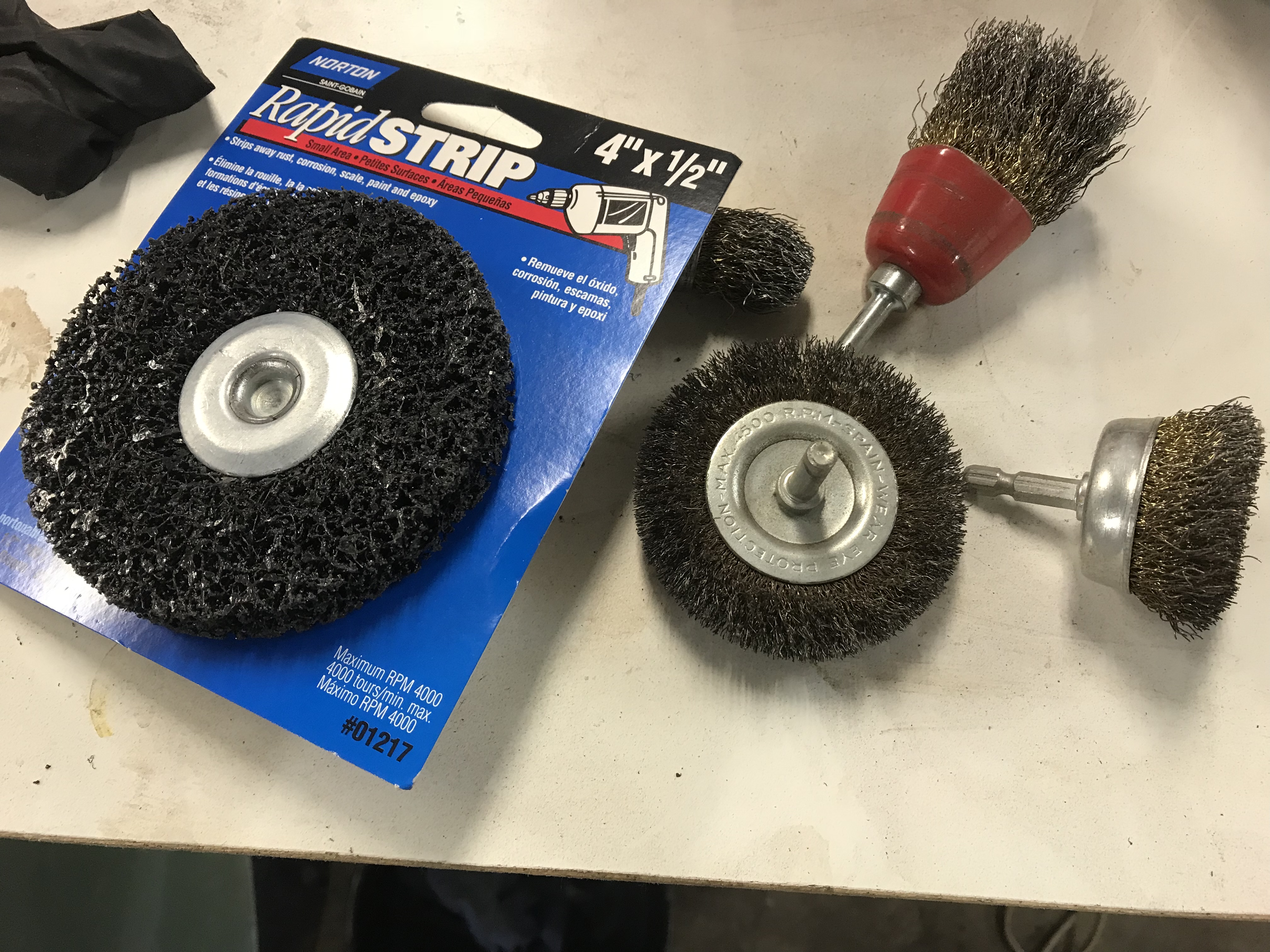

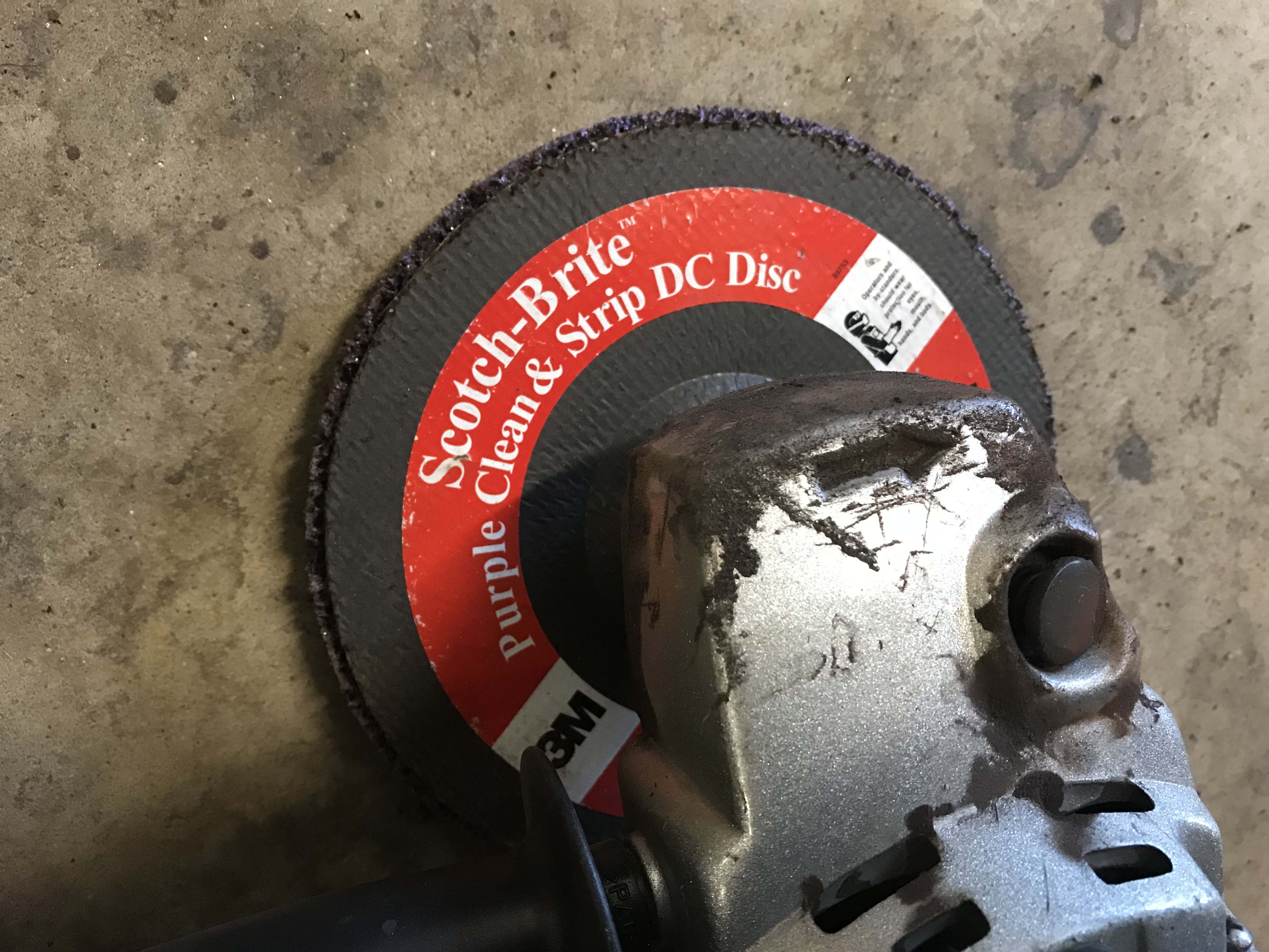

Cleaning metal started with combo of sanding discs, pads on sanders, grinders, wire wheels. Wire wheels good for getting into spot welds.
Rust treated with an acid rust cleaner, (wearing long acid proof rubber gloves)applied then rubbed into areas turning black with sandpaper.
Then wiped clean with a damp rag and dried immediately with dry rags. whole process repeated where rust still on metal. Some small bits of rust had to be removed with a die grinder.
If any acid is left on metal it will turn white when it dries. It needs to be washed off and dried.
Where parts were left for a few days without sealing i repeated acid treatment before sealing and then cleaned metal with acetone then was sprayed with the apoxy coating.
I found that having as many different type and size sanding discs, pads, wire wheels as possible made the job easier.
Most of these products have come from a business called Crash Supplies in Adelaide, don’t know if that is a an Australia wide chain. I did get a few bits from super cheap auto parts but they have only a pretty basic range compared to a proper auto body repair supplies.

I've been using 3M rust dissolver before I puttied the damaged area. Similar process as to your product, but has to be cleaned and puttied or sealed within 20 minutes. I won't be using the 3M, I will be using a product called bondall Ranex. This is industrial strength rust buster. Similar process, but can leave it to completely dry. I'm going to give it a day. Re clean again and then prepsol or acetone it.
Redback is right in calling those wire brushes "wheels of death". I wore a welding jacket when I used one of them. The wires broke off and speared into the jacket. Lucky I was also wearing glasses as one strand also speared into my left ear. The left pokes out further than my right. Halfa' wingnut you could say. I've gone back to using twist knot brushes.
Thanks for the info. Will be following your 'Resto' with interest.

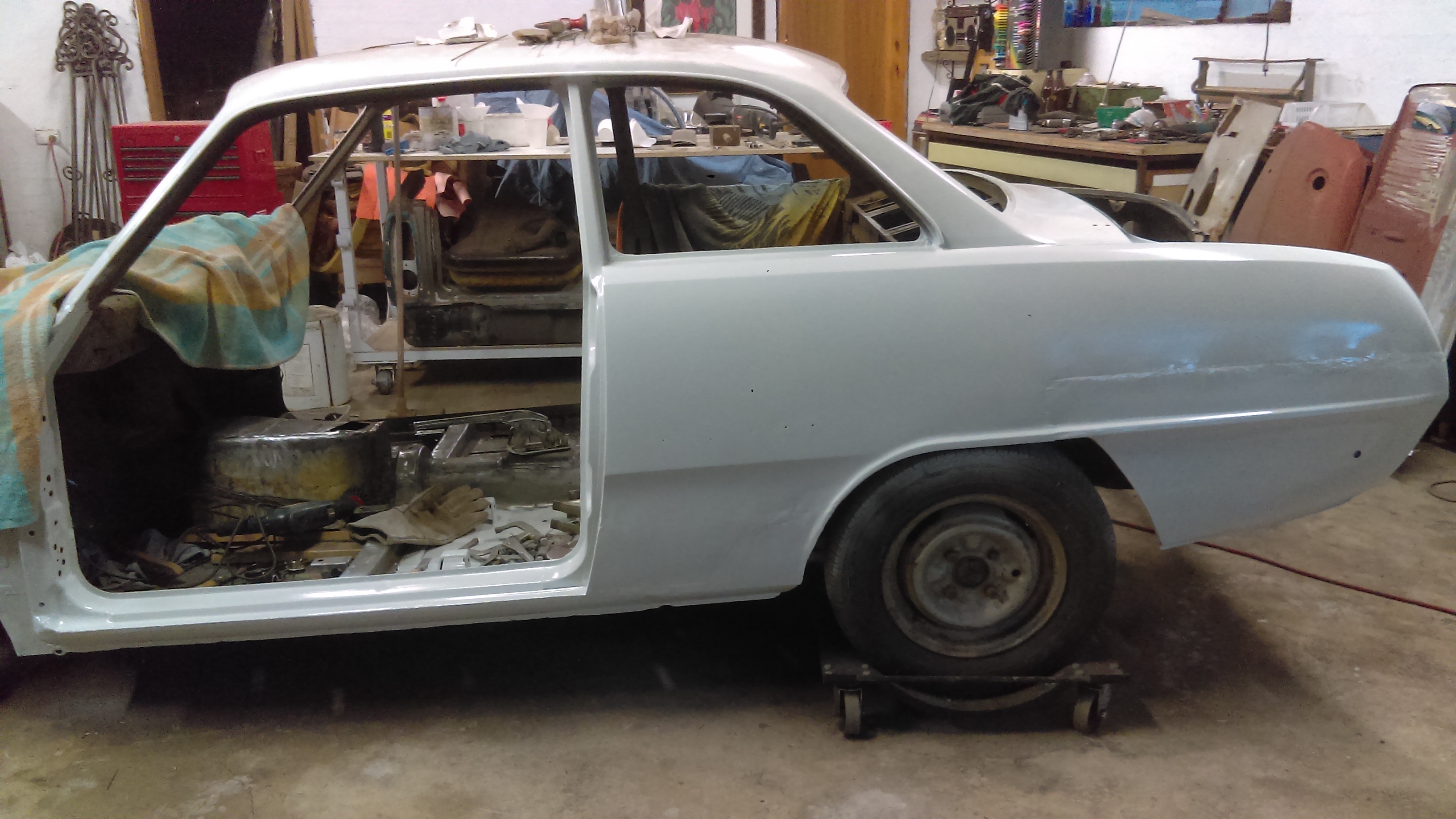

Bit of an update, new sills ready to weld in, rear end started welding on, lots of metal cleaning, apoxy sealing, more updates as weather gets warmer.

New sill welded and coated today, rear quarter coated. Will spend next 2 weeks finishing cleaning boot metal and interior floor metal before rest of rear end gets welded on.
