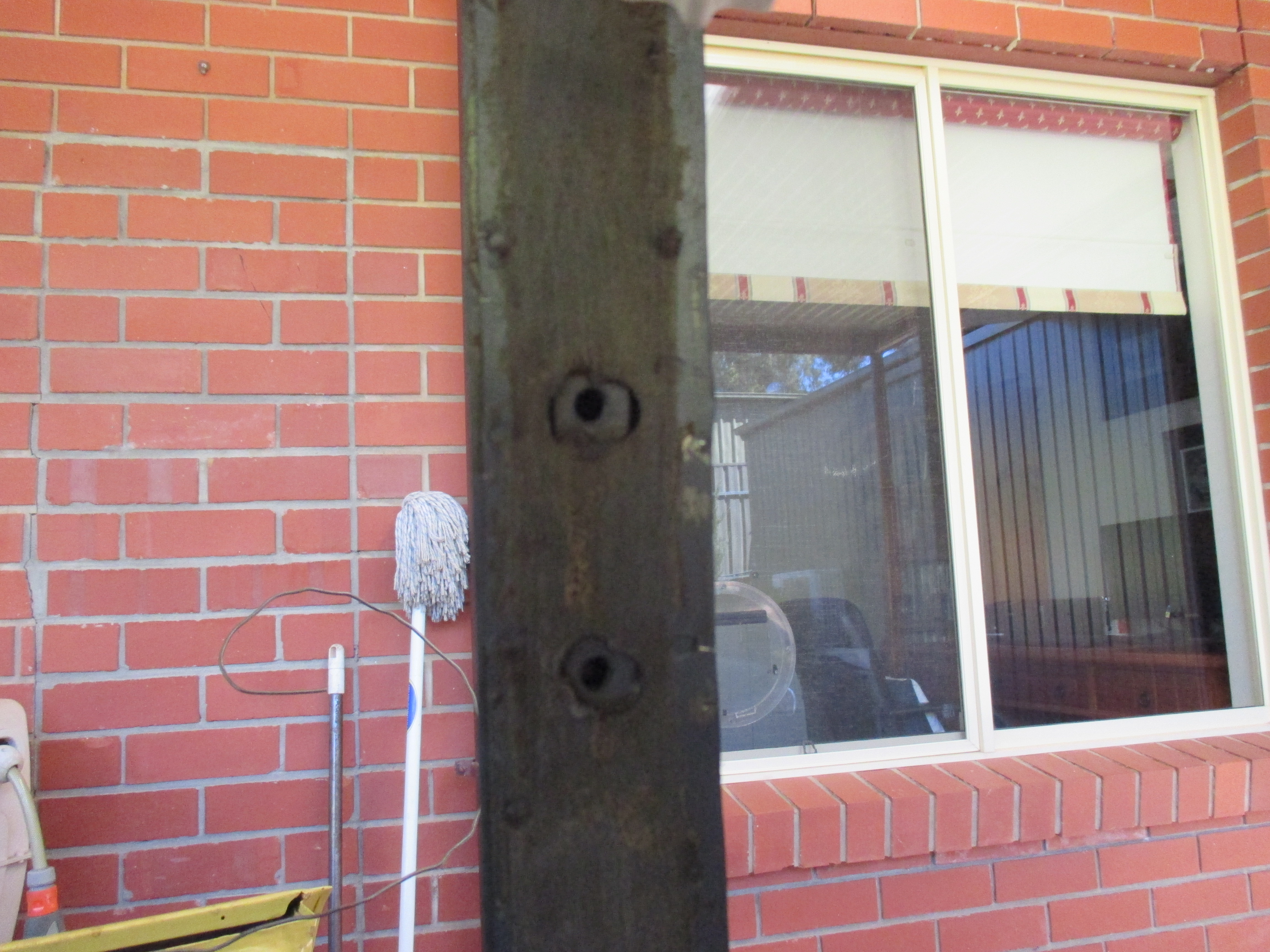

removed the hood lining today and discovered two holes with captive nuts in both B Pillar. These were covered over by the original trim, could they be for lap sash seat belts?

I've only known of 1 being there. Not 2. My first sedan ('67) had them in it. I didn't find out about them until after I wrote it off.
They look like, and I could be wrong, someone has been experimenting on the position of the top of the harness.
"B" pillar trim hides lots of things.
After the panel has been pressed the nut for the bolt is welded onto the inside of the panel and in production the outer and inner are welded together.
The hole for the nut is a lot tidier than that.
Thu Mar 07, 2019 5:36 am
I reckon Dave could be right. Holes have been "ovalled" out to let the nut slide in on its side then stood up. I could be wrong
too..!
Thu Mar 07, 2019 6:01 am
Posts: 76
That's really odd to have two positions. Maybe one for the Japanese market and one for exports. ;)
Besides I would've thought they were only lap seatbelts back then in the early models.
Thu Mar 07, 2019 12:54 pm
My thoughts are the bottom one an anchor anti the top one a loop, some 2 door yank tanks we set up this way ???

All seatbelt mounting nuts worldwide are 7/16" x 24 threads per inch. (TPI). UNF.
