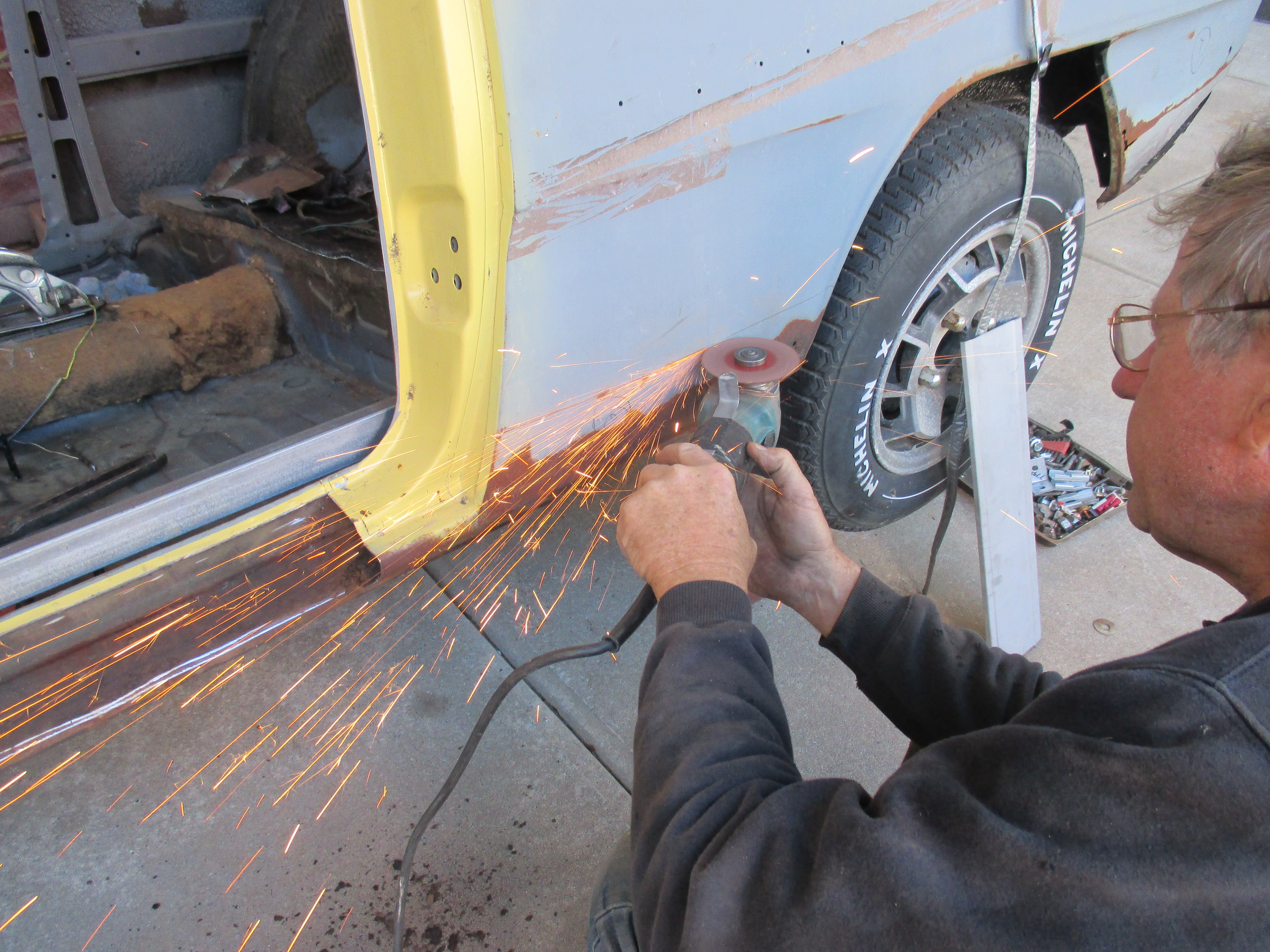

Well it has been a while since I first posted the GT on here but I had to clear out another project and wait on my panel beater before we could start on the body. That work has now started and I will be posting the rust repair work as we take the GT from start to finish over the next couple of months. First item was the structural work and that has started with the passenger side sill and A pillar. As we went along and opened her up it became evident there was more rust than first thought. To keep the integrity of the car we also had to make sure it did not sag when the sill was cut out hence the frame work you see bolted into the passenger side. The passenger sill is now replaced and the bottom of the A pillar, a lot of fabrication has gone into replacing the rusted sections in the top of the A pillar and these are ready to be welded back in one at a time section by section. Still have to fabricate the top section and weld in. This will be completed next week and the driver side sill will be replaced then also and work will commence on fabricating sections of the driver side A Pillar the same as the passenger side. Hope you like the pictures.
Regards
Peter
