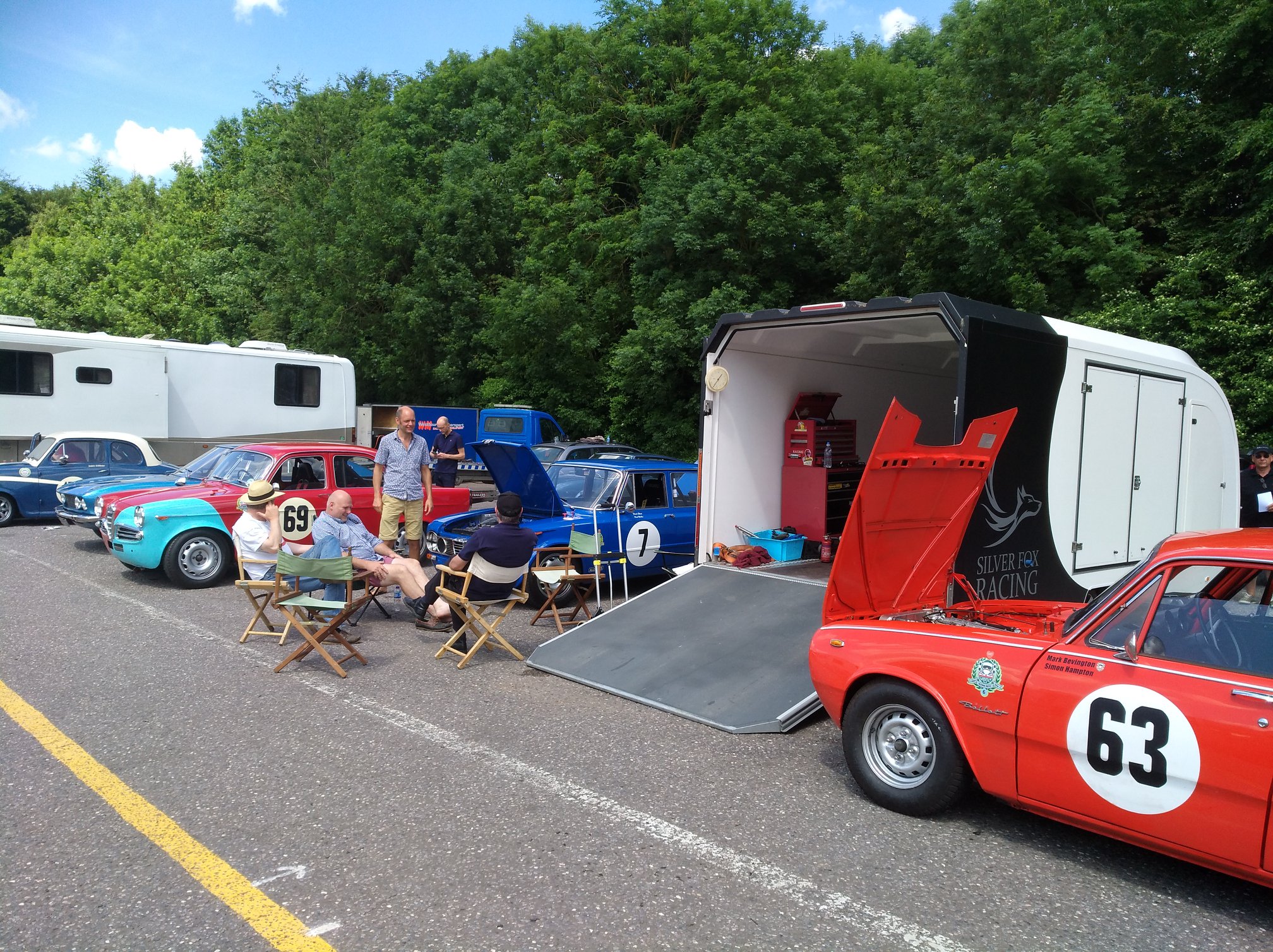

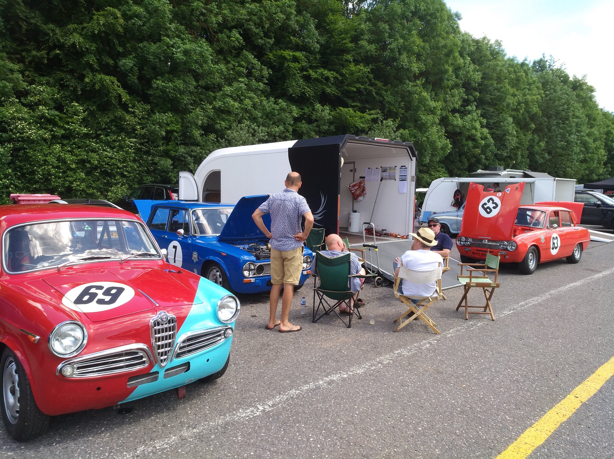

To remind me why we're going through all this I've posted these two shots that have just surfaced.
I think it's a nice depiction a bunch of relaxed amateurs loafing around, before they go at each other, hell for leather on the track.
Tue Jul 14, 2020 11:50 am
And people wonder why racing costs a lot of money. Lots of 'little' things.
Looks like a little blue Alfa there ?
Wonder if he has seen this series of videos, an Alfa having a V8 Ferrari engine fitted to it. LOT's of work.
This is part 51 so its a long story......... https://www.youtube.com/watch?v=ZKhaF1Lr9zU
