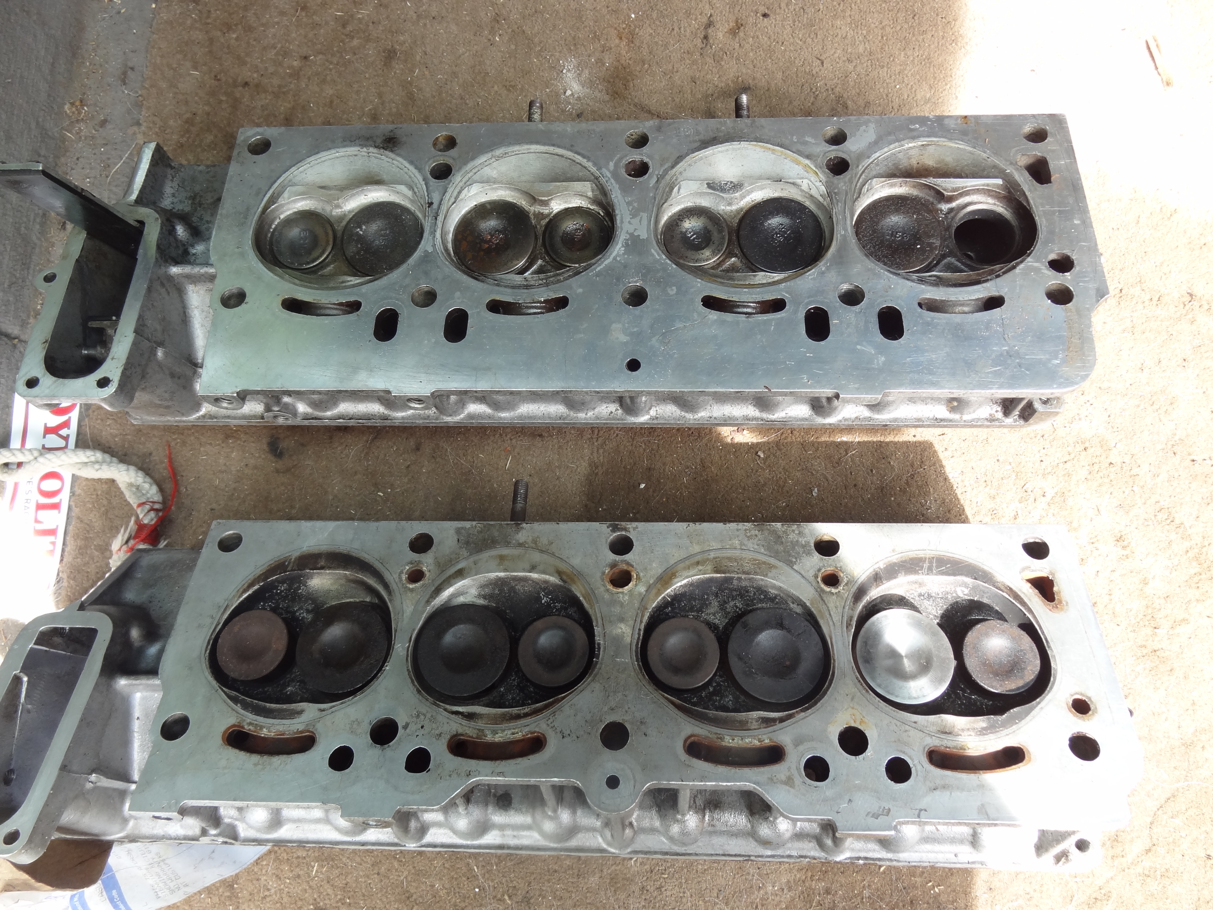

Well, the 1600 head has gone onto the 1800 block..and our Frankenstein engine is taking shape. The theory behind this strange hybrid, is that the smaller combustion chamber of the 1600 will give us more of our much sought after compression. Top is 1600 above the 1800.
We calculate we'll get somewhere around 10.5 - 10.6 : 1
There was a bit of fiddling around with one of the oilways,but otherwise it's on
That should set it alight, Mark.

Hi Mark
The 1600 head looks like a better shape than the salad bowl 1800
Is it an optical illusion or are the 1800 valves bigger?
Regards Flying
Mon Jun 22, 2020 10:46 am
From memory the 1800's valves are marginally bigger....but rather annoyingly they are also a couple mm longer.

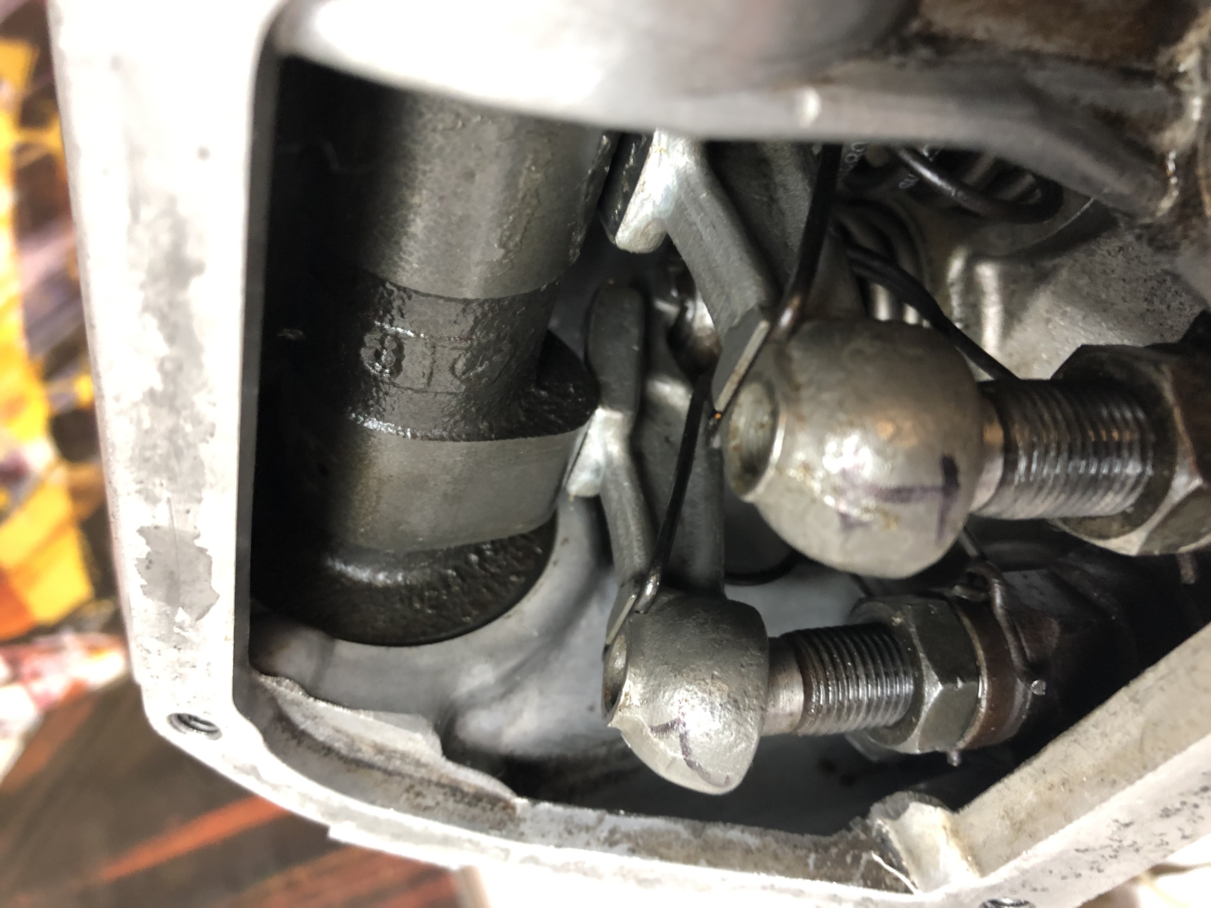

The new cam, with its higher lift, is now attacking the rockers all wrong.
To correct this longer valve stems would do it....or easier thicker lash caps....here's some we made earlier!
This will allow us to wind the pivot screw in a few mm and pull the follower back toward the middle of the pad on the cam.

Anyway, our tall lash caps have certainly improved the rocker geometry.....

Where do those gadgets fit ? Even though I have a SOHC I have never seen inside one.
