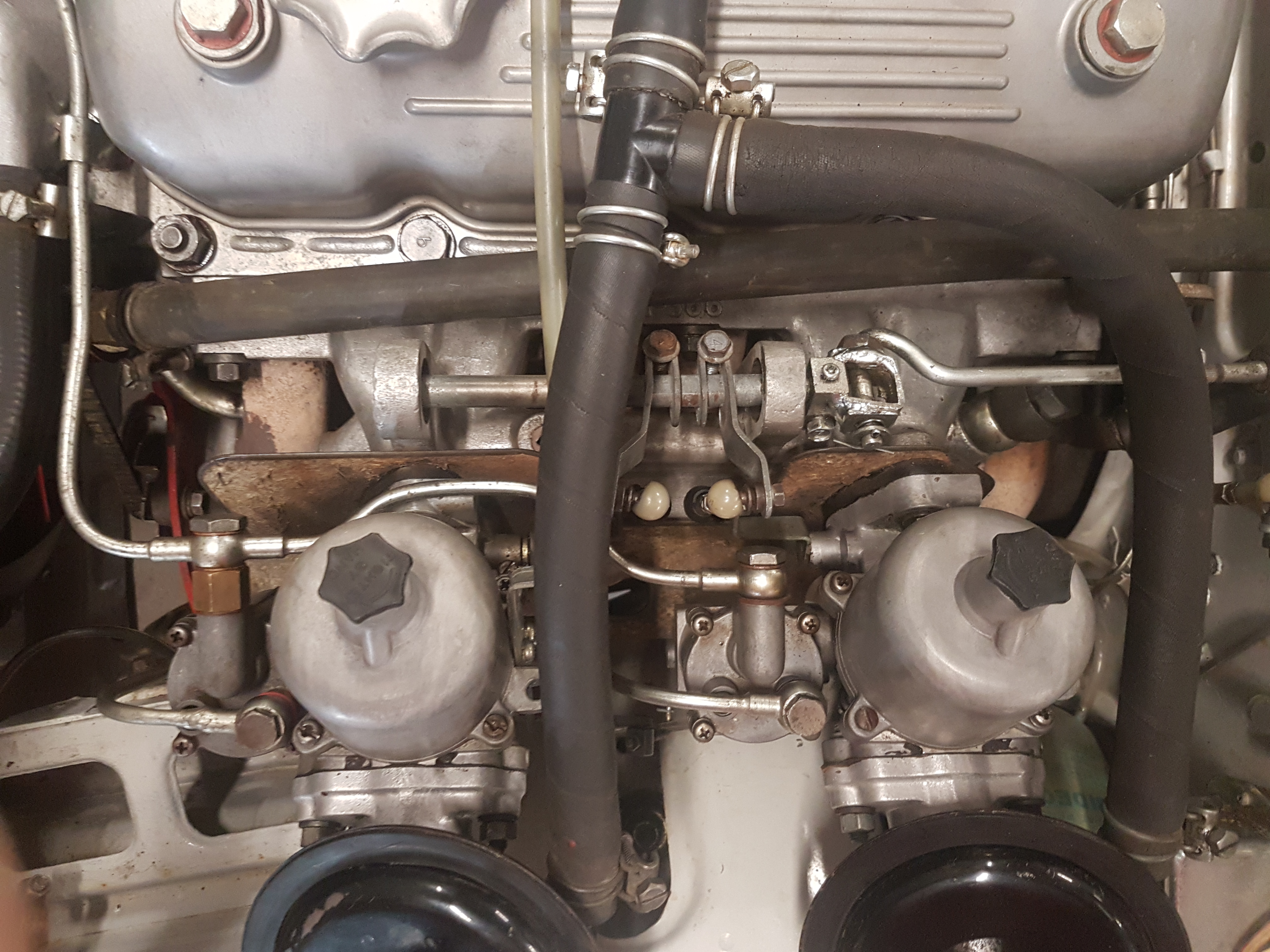

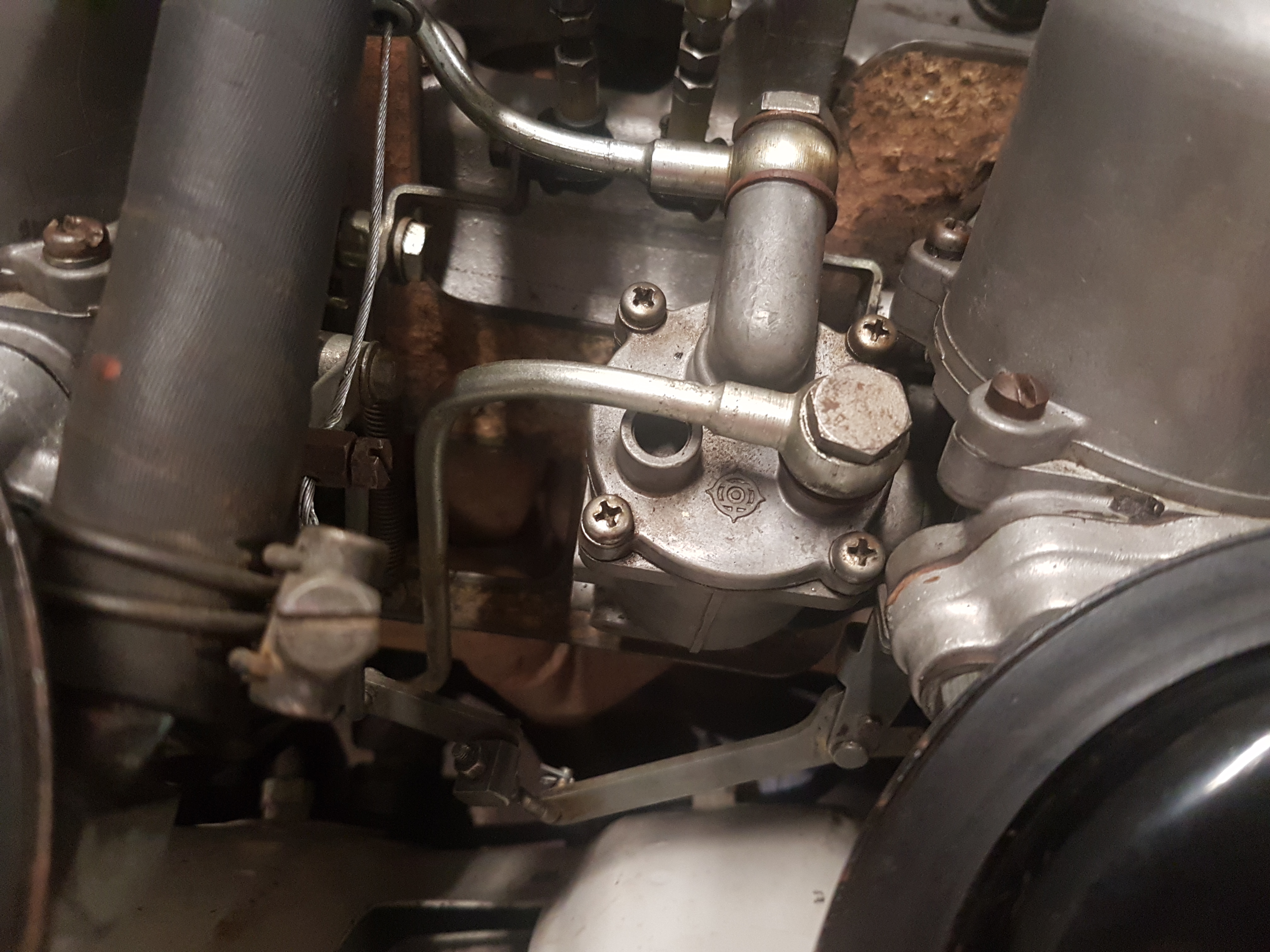

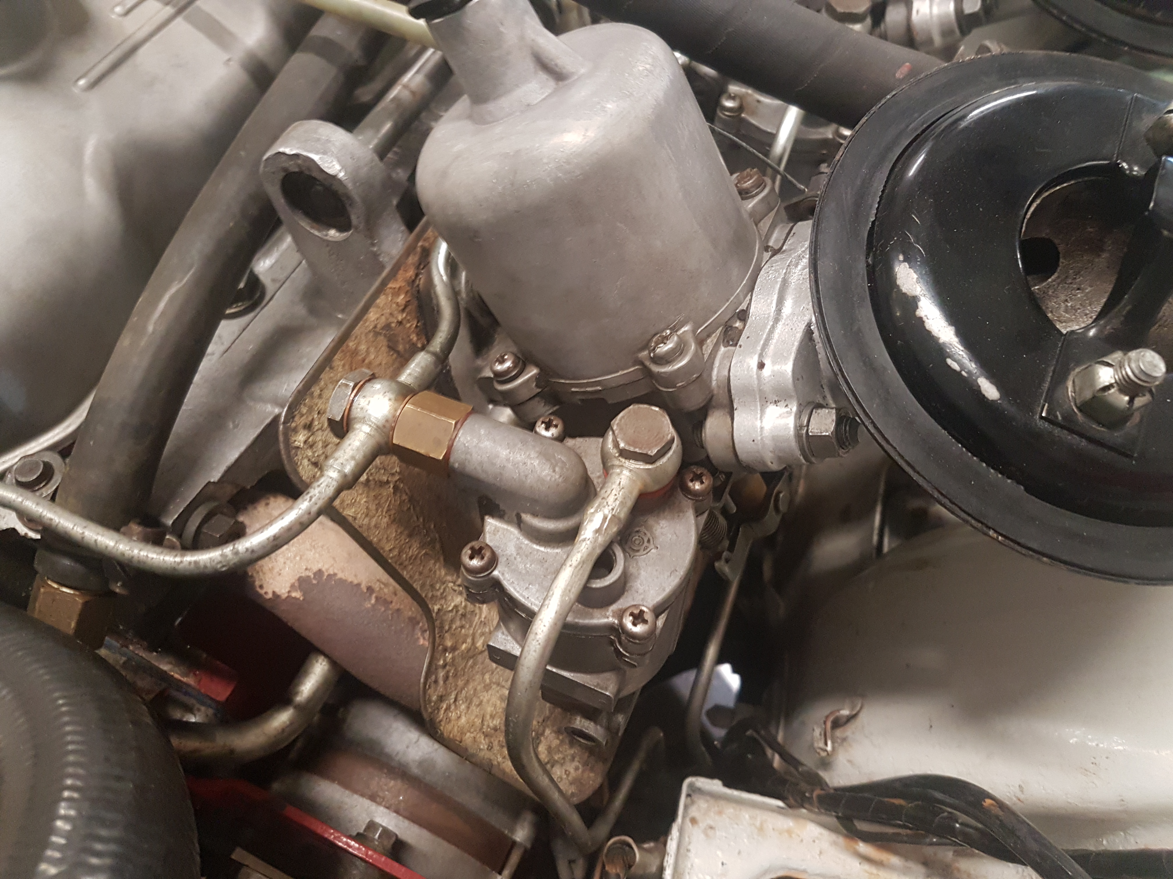

Please Post a few current pics.(engine bay , interior etc..) of your Bellett ...we would like to see it .......it is always interesting to see a later model in detail)
Here are a couple more "carby pics" (1967 PR91 Bellett GT) for your info. /reference .

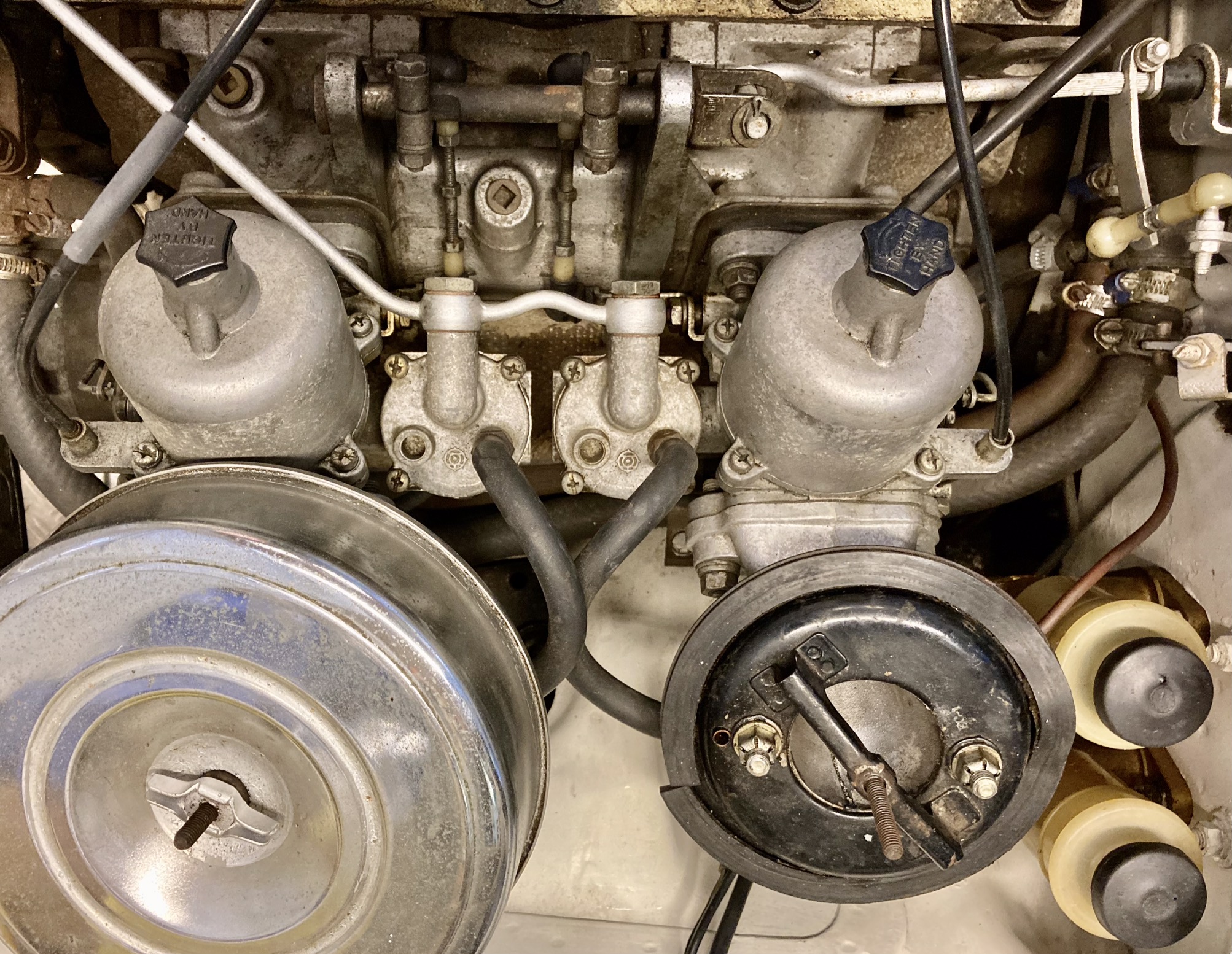

A bit more symmetry this way? One of the seven beauties ... ;)
I think the primary function of the hose, from bowl to intake, is to vent the bowl.
Second function: in case of flooding the engine will stall.
