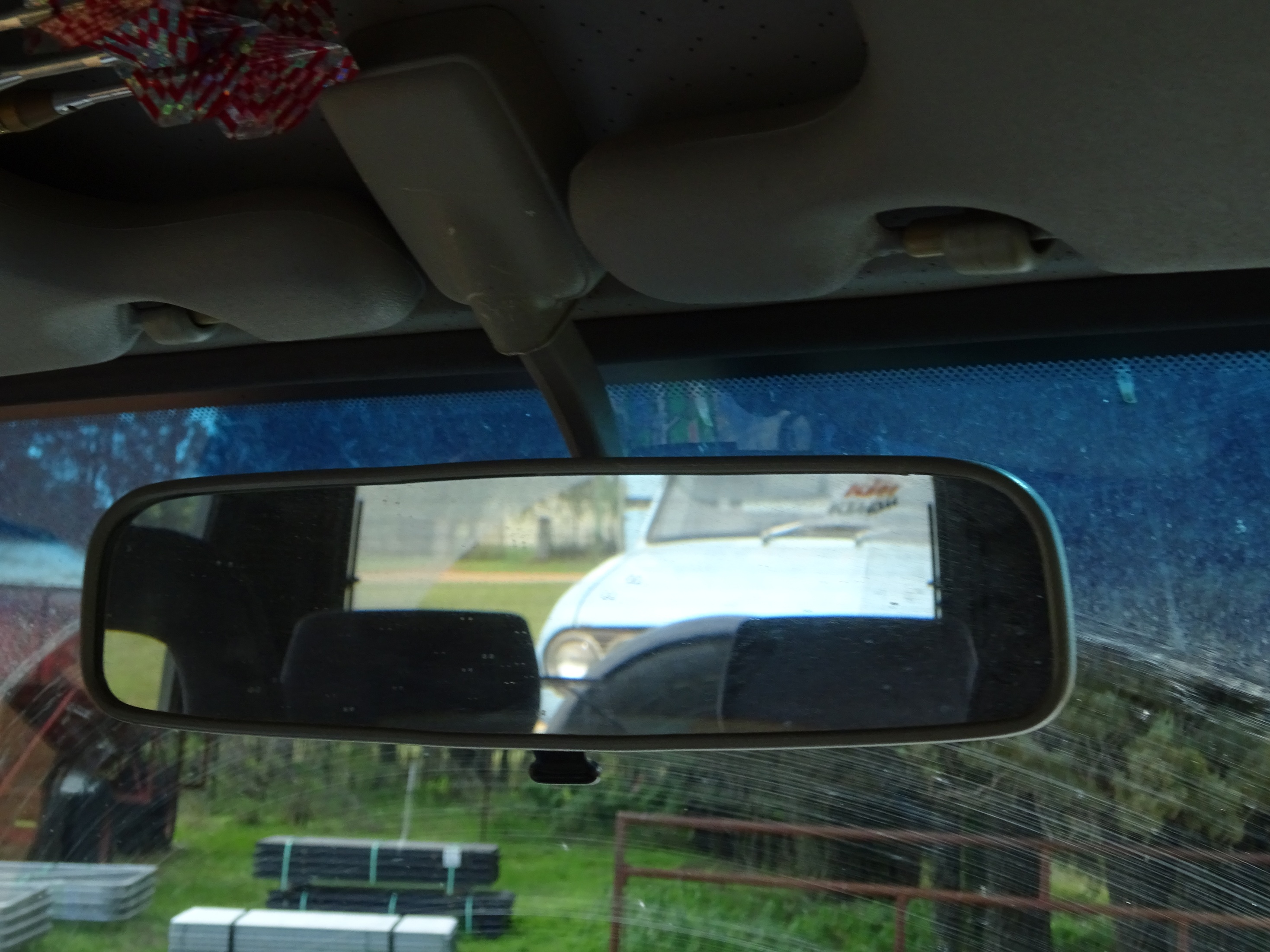

As I left I couldn't stop looking in the mirror and smiling like a Cheshire cat.
