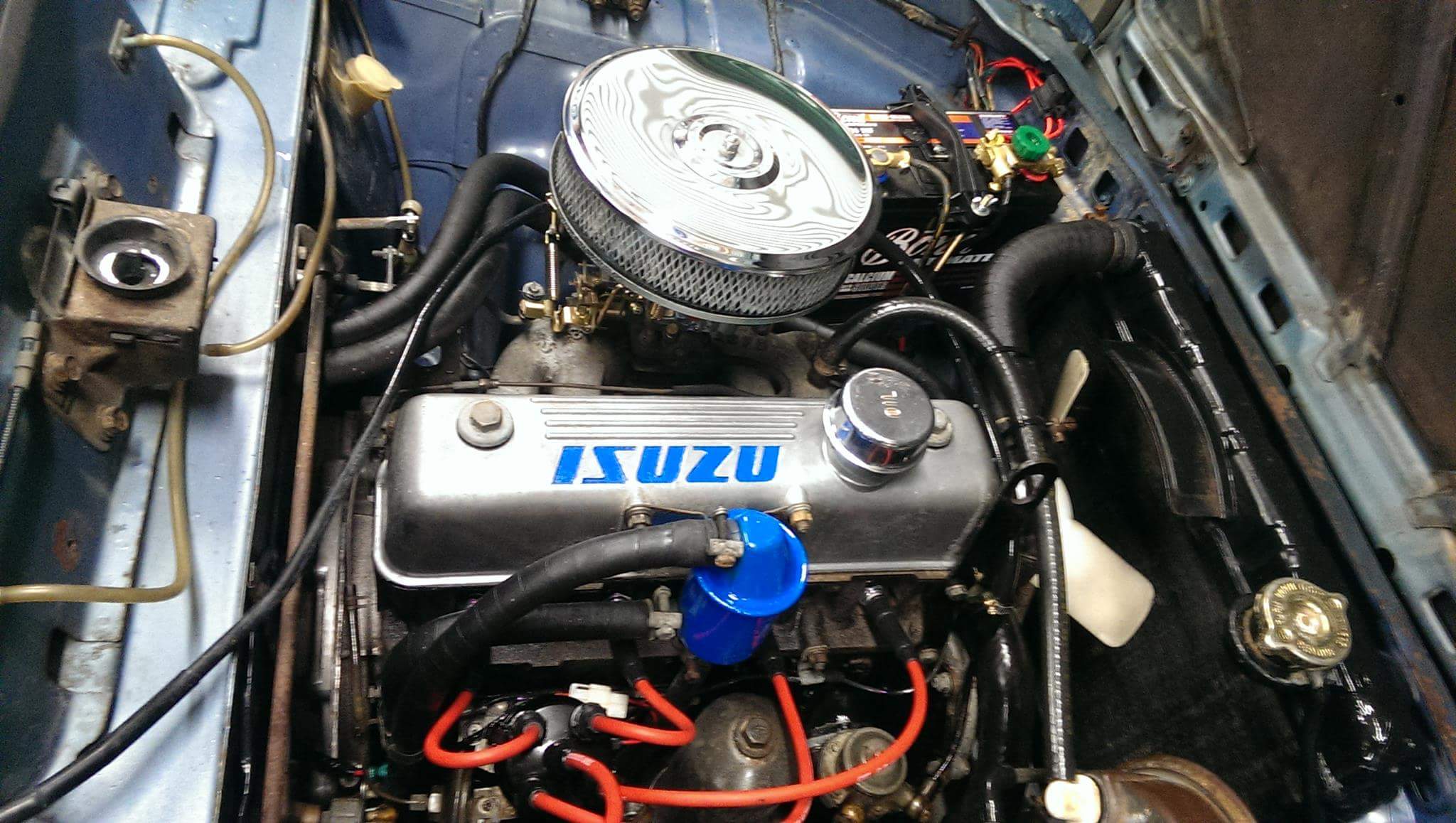

11885767_10200979935658626_75357380696336867_o (1).jpg [ 251.94 KiB | Viewed 65018 times ]
Gemini fans.
Any rear wheel drive 1975 - 1984 TX - TG Gemini will have one. Front wheel drive RB Gemini is different.
Rodeo an Jackaroo is different again, but will just fit with some fiddling. Best off to use the more common Gemini one.

hi guys got the gemini fan took off the yellow steel fan came with a round type spacer with 4 holes as the bellett gas now I put back on the fan pulley first (check) then whats next the bits are plentiful and alto I got bretts pic its not in detail anyone please help me cheers davo also heard theres a pr90 for sale .................
Fri Jan 13, 2017 7:23 am
Hey Davo
The Fan should go on without the spacer
Then check that the fan clears the belt and the radiator
Cheers Flying
Fri Jan 13, 2017 7:53 am
Bolt the Gemini fan straight onto the Bellett pulley.
Everything clears fine.
Fri Jan 13, 2017 8:39 am
Brett, I would have thought he would still need the spacer or would need to use shorter bolts, or is the gemini fan thicker? Keeping the fan closer to the radiator draws more air through too, I reckon. I have 2 different thickness spacers in my parts bin, though I don't know where the thinner ones came from.
Fri Jan 13, 2017 12:52 pm
guys now you got me the old system steel fan the pulley ,steel spacer which pokes thru the old fan and 4 long bolts ...the new is plastic fan 4 short bolts and a round cap (spacer) that the holes line up with the plastic fan hmmmmmmmmmmmmmmmm what now ?????.
Fri Jan 13, 2017 9:23 pm
had a good help today between josh and brett trying to get frank spencer to fir a fan and yes I put it on backwaeds hmmmmmmmmmm how was I too know betty never knew either ...thanks guys
