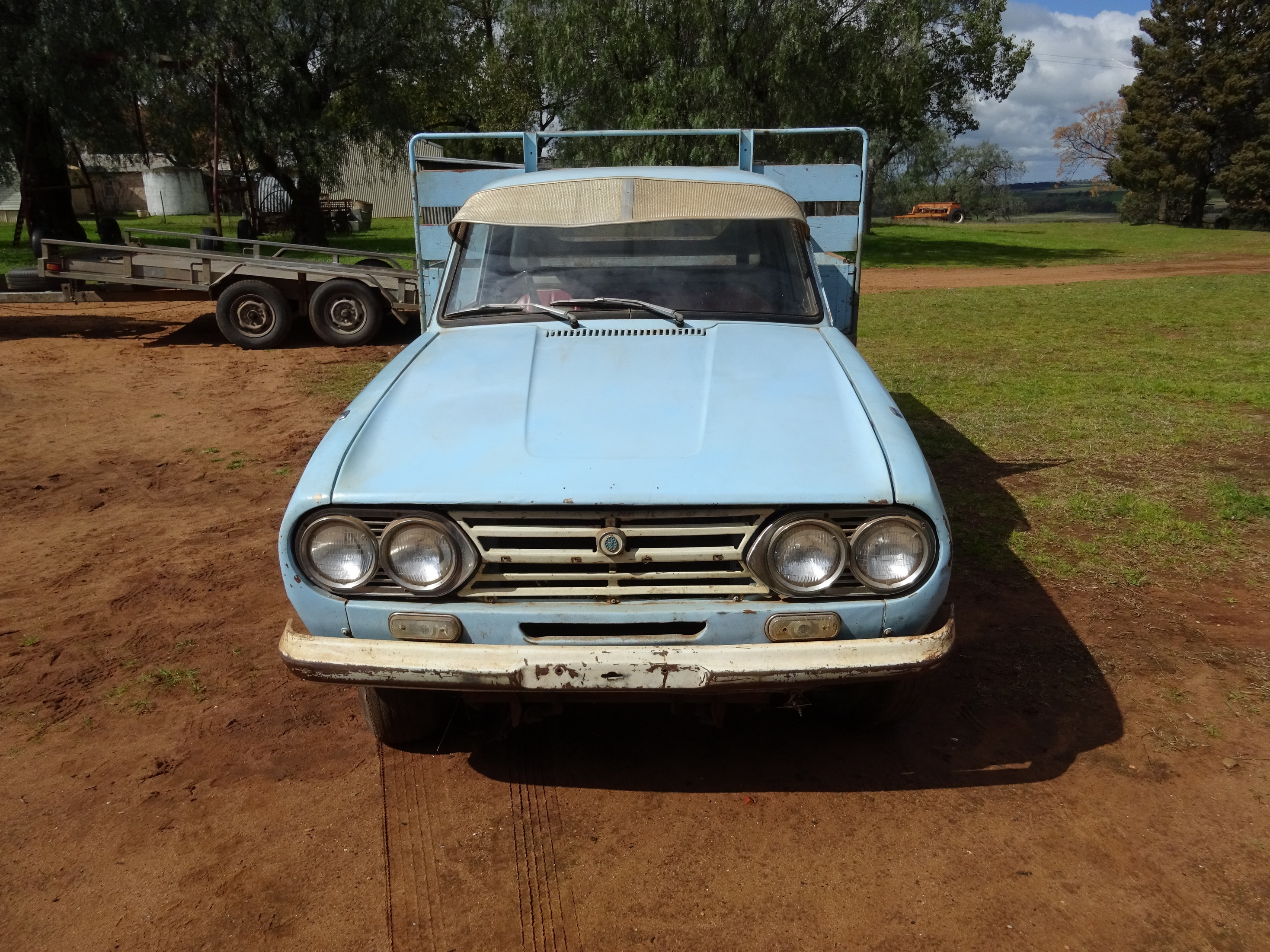

My Dubbo Wasp
This ones for you Matty :)
The Facebook picture that made me fall in love with a 1 owner, baby blue ute from Dubbo.........
Fri Mar 03, 2017 12:20 pm
Some pics from the day I picked it up and the road trip home..... back roads style :mrgreen:
