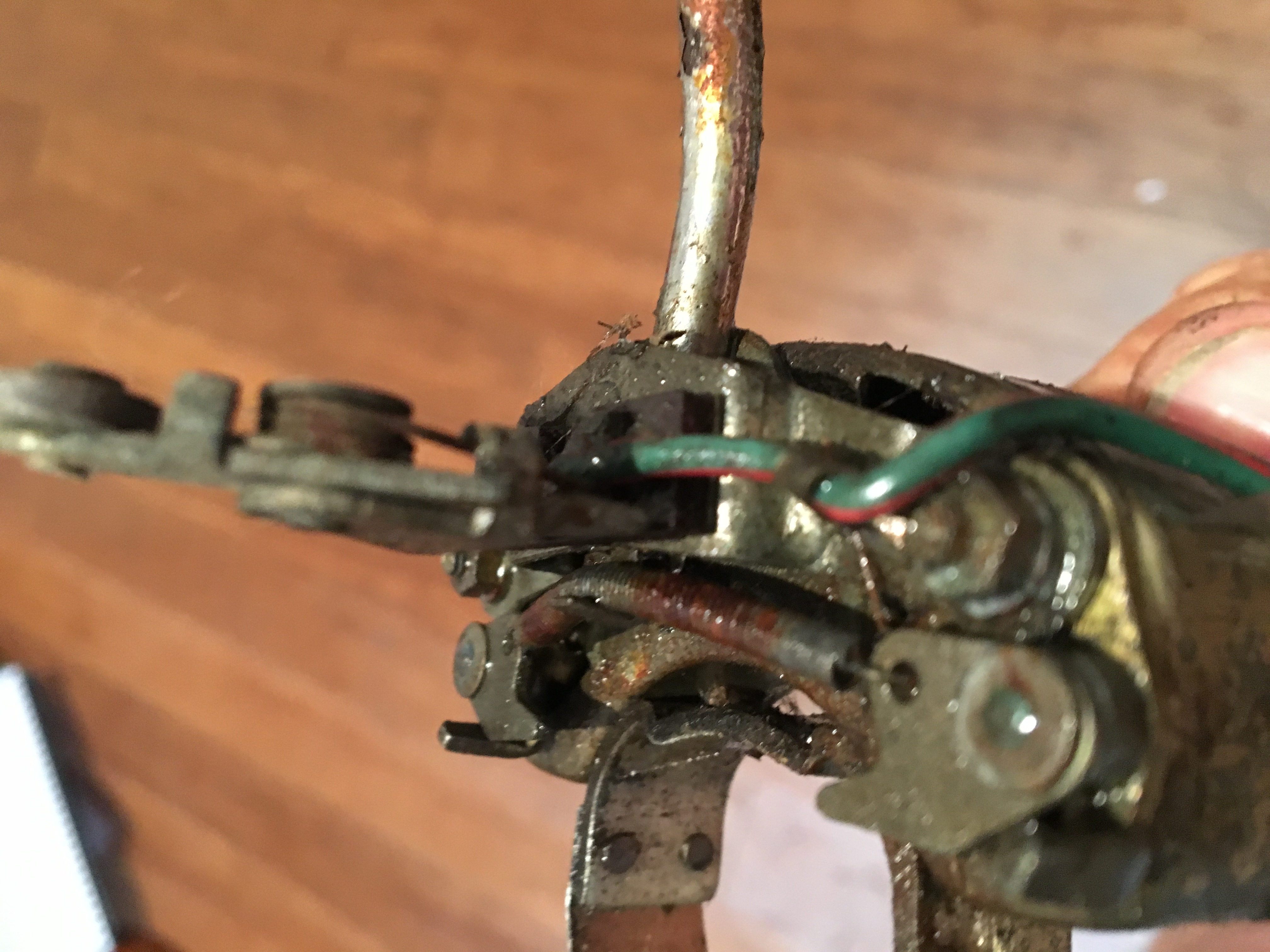

The day wasn't perfect, somehow the turn signal switch stopped working. It does not lock in turning right position. Is there some kind of spring which should keep the switch in position?
I hope it's not too difficult to fix it.

Hi this is how it should look for the blinkers. Does it make sense cheers dave
Mon Dec 04, 2017 2:26 am

My turn signal switch seemed to repair itself overnight. But I should probably clean and lubricate it a bit.
