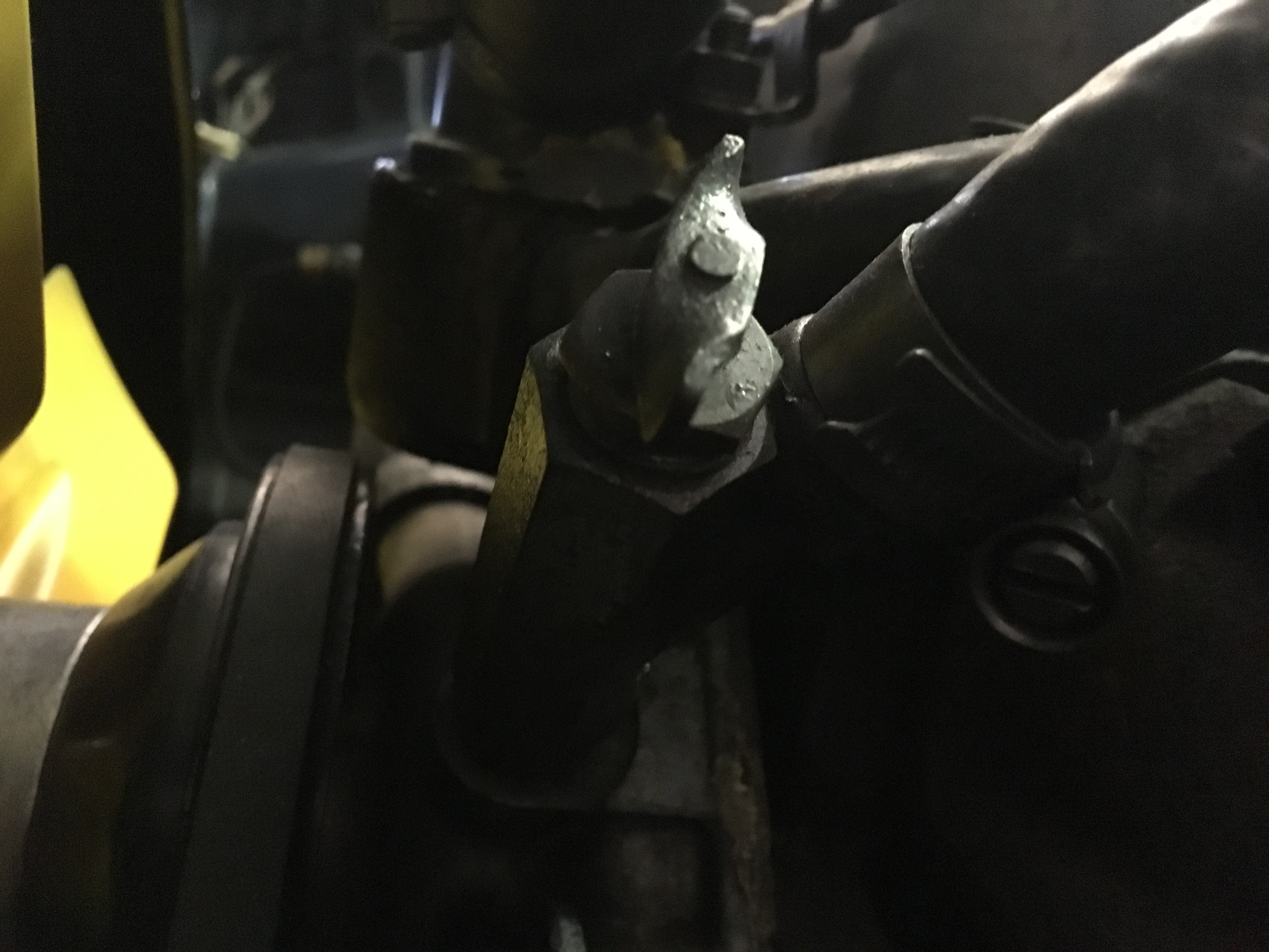

This is the old style tap it works again after a bit of de freezing it
