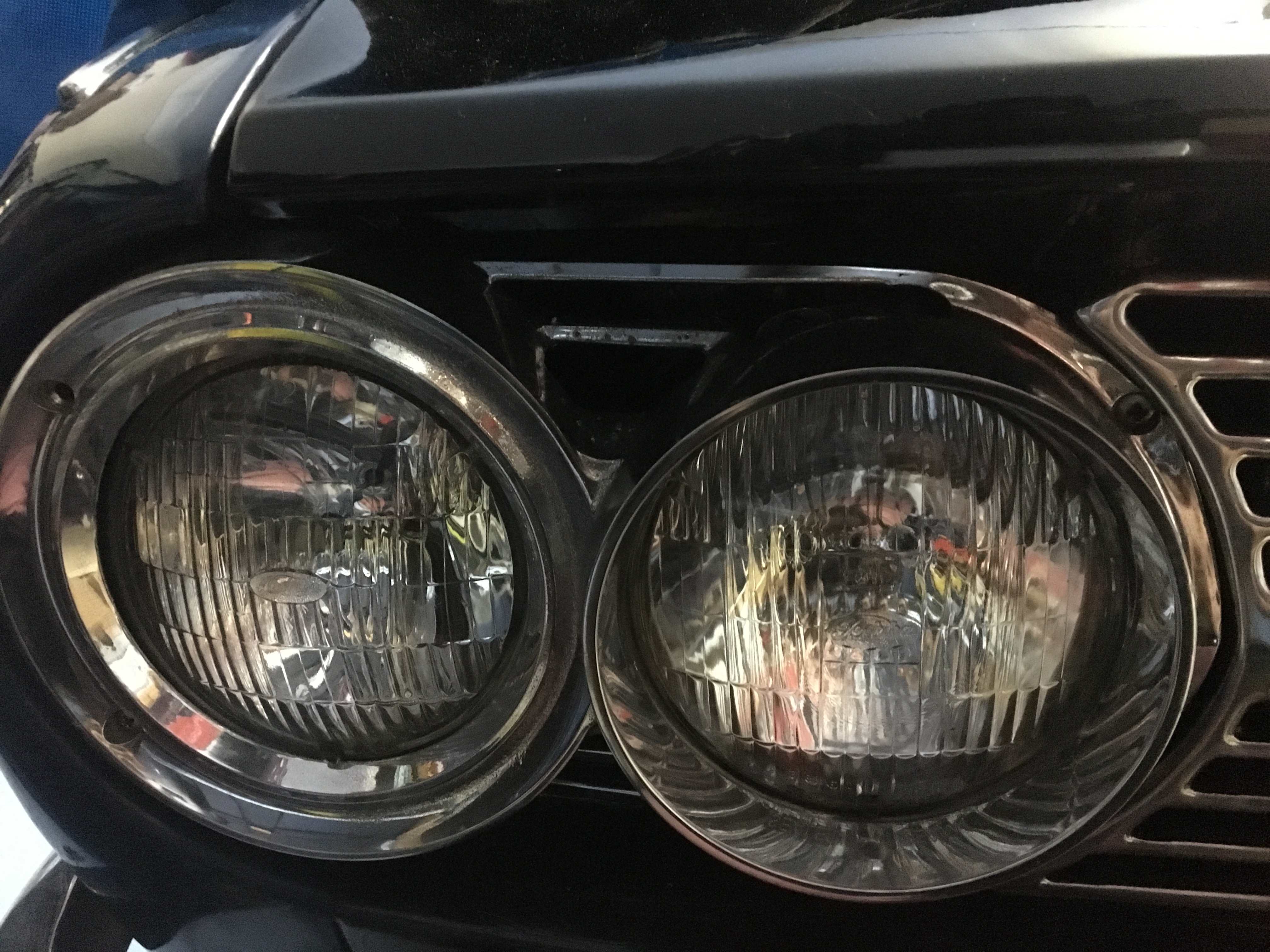

Here are mine they look the same ?

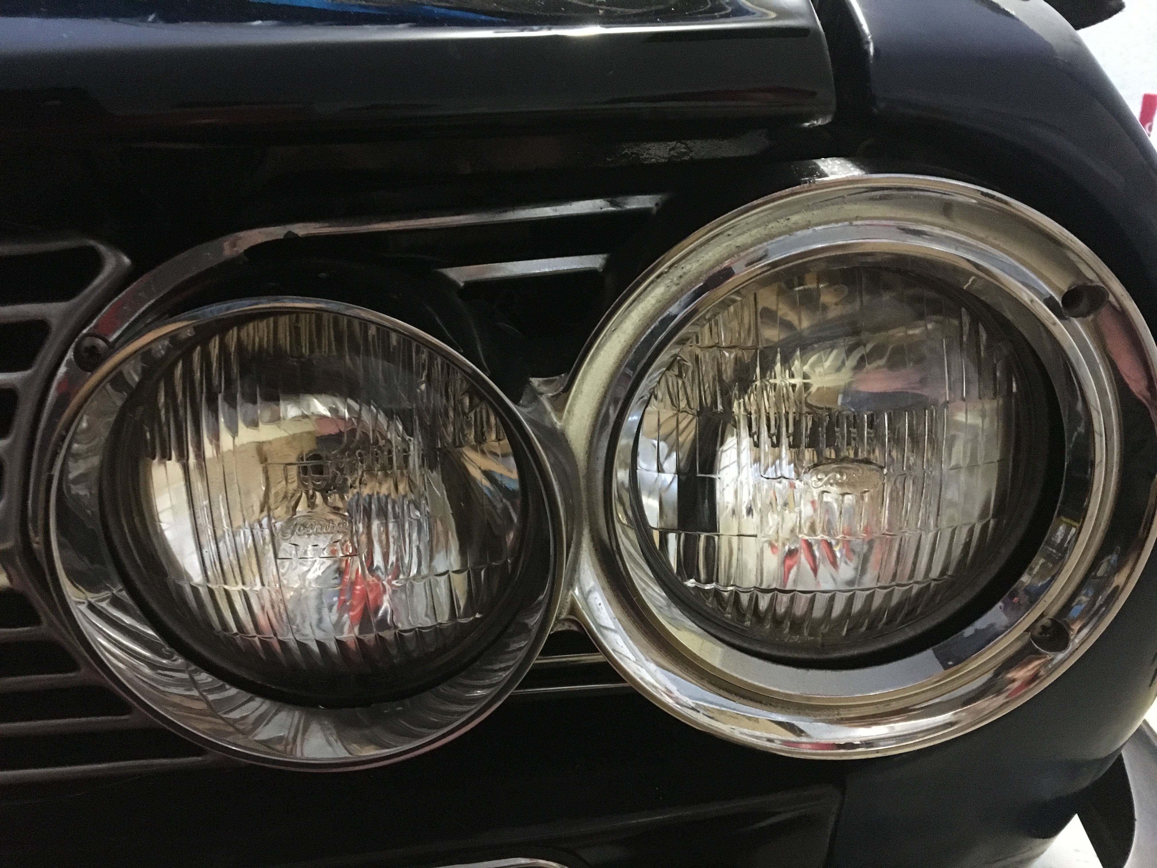

The other side

Bullitt, on your pics they are the same as my left one.
But here, on the time machine are the same as my right one.
Actually a minor difference, but still. It would be interesting to know.
