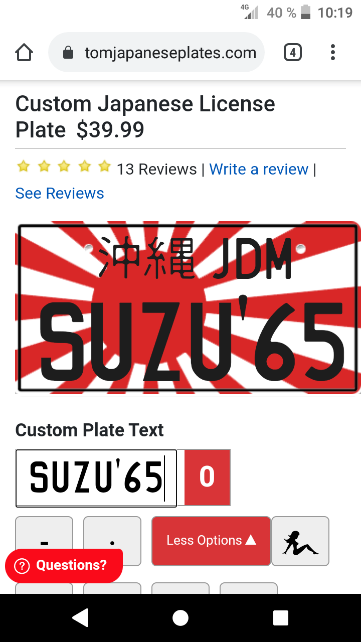

Maybe it needs some nice new reg.plates someday ;)
