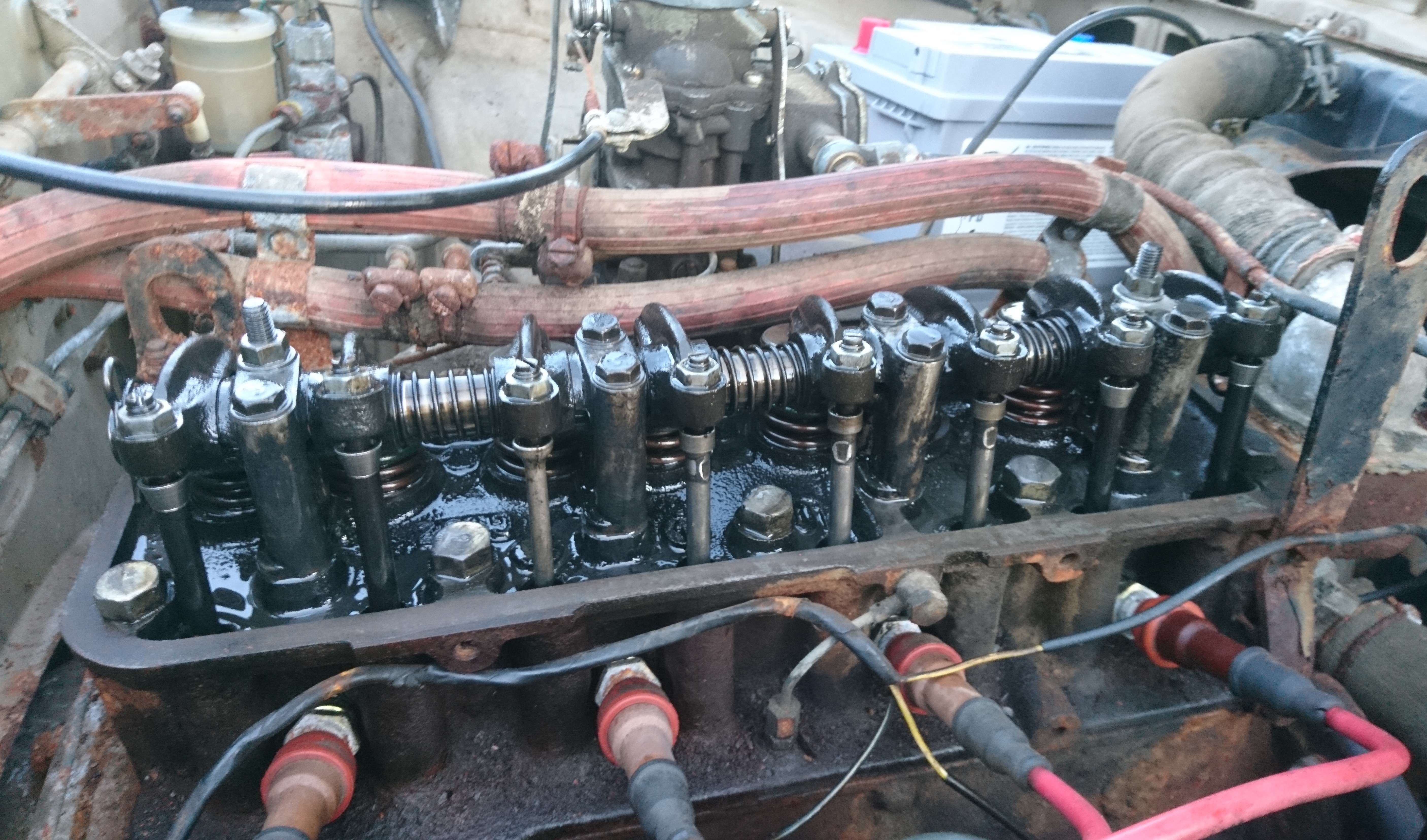

3b. Discovered that I need to replace atleast 2 pushrods.

Finally got my custom length pushrods that I ordered! fits perfectly and doesn't rub anywhere, nice! 8-) had to use some "Tecnosil" black sealant on the very very old, crispy and broken valve cover gasket since I didn't have a new one laying around :D

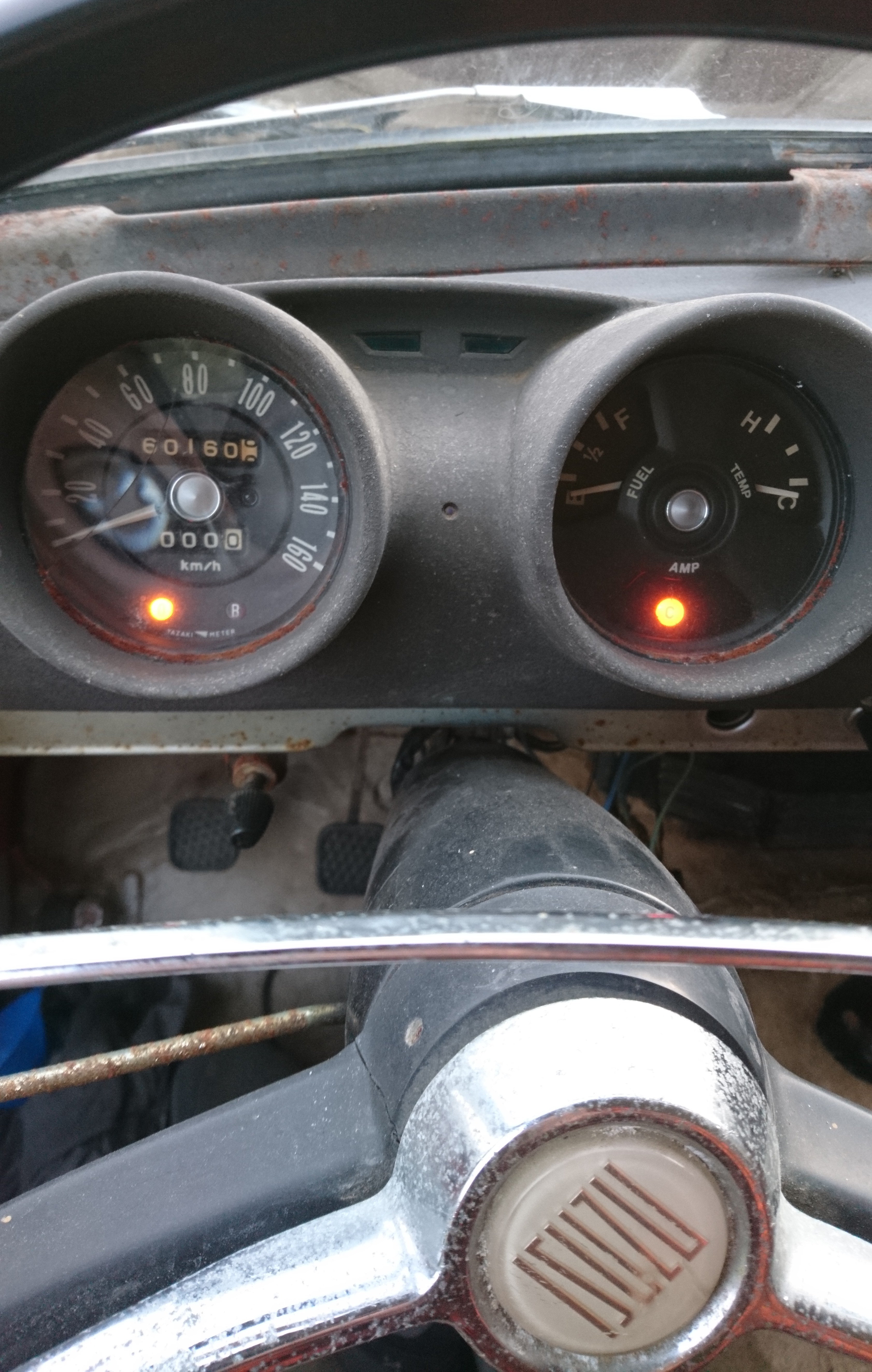

Did also get most of the interior electrics working, gauges, lights, warning lights and switches.
